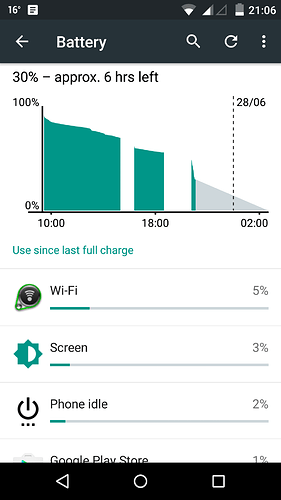

As an aside, I find that when I look at the battery status, if it’s done the weird crash, the status is strange, suggesting some sort of problem for an hour or more before the crash; in this case, twice today the battery status is blank for a period; the status reappears when I’ve rebooted after the crash. On the second occasion you can see I got the “apps optimising” thing and the battery has drained a lot. However, I can confirm that during the second ‘battery blackout’ period I was using my phone a few times, checking apps, and all was apparently fine until the crash.
I’m going to go look up how to downgrade to 1.3.6 now because this has only been an issue since 1.4.2. 1.4.2 has rendered my phone almost unusable as a primary phone, as at any moment it not just dies but remains dead for 15min+.
