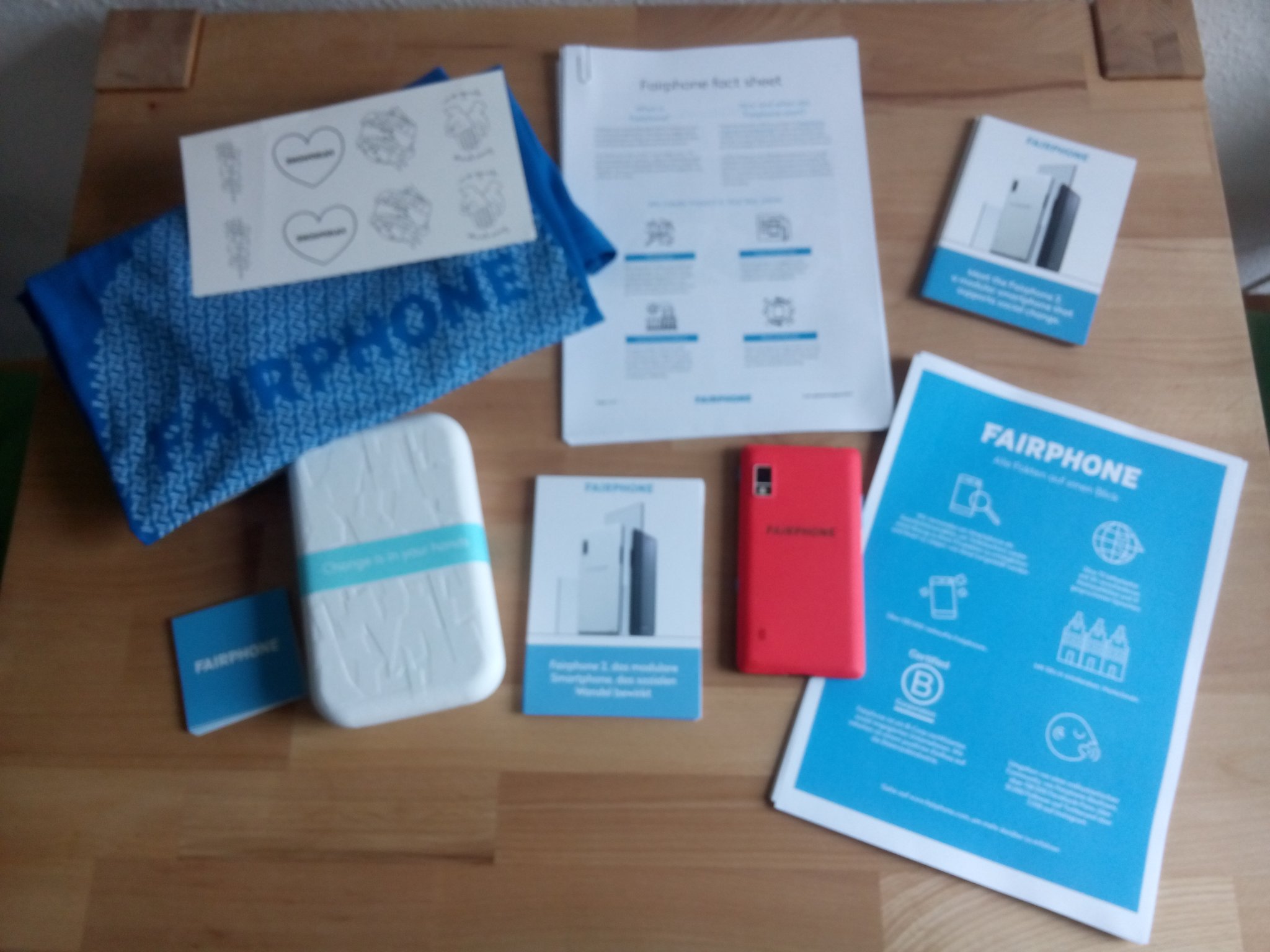

I have both FP1 and FP2 and the new one is simply better in every aspect, except battery life. For me the battery in the FP2 lasts 1.5 days on average whereas the FP1 lasted 1.75 days (rough estimates). But it’s an almost insignificant difference :wink:
The biggest improvement for me comparing the two
  • the FP2 is a lot more snappy (try switching profiles in the twitter app)
  • the camera is light years ahead
FP1 photo
FP2 photo
And of course all the other benefits like monthly security updates or running LineageOS (Android 7)

Huh, the FP2 replaces the red cover with a FP1 when it takes a photo!? :flushed: :joy:
Well the FP2 in the picture at least has the new camera & new cover. You can add to the pros of the FP2: the phone can be improved by swapping a module! (edit, I’m sorry, you already mentioned ‘upgradeable’)
@Stefan Your FP1 doesn’t support teleporting itself either, right? :joy:
I wish I had had a FP2 when I lost my FP1. I could have gotten it back using the FP2’s teleportation module. :stuck_out_tongue_winking_eye:
