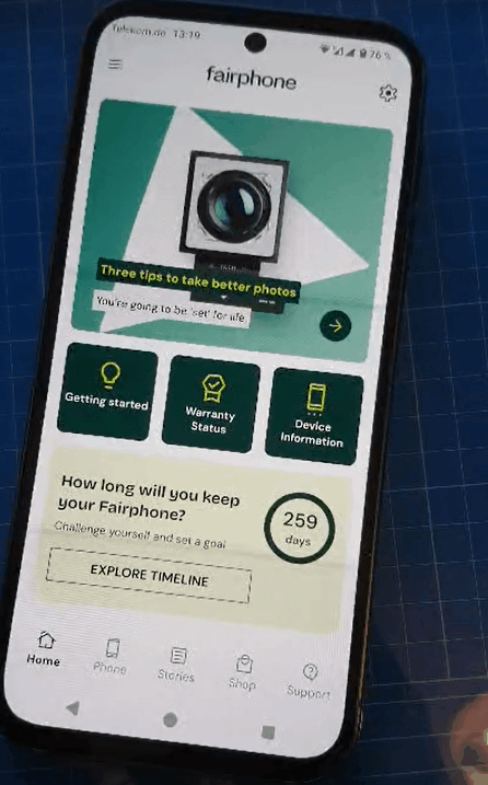

My FP5 screen has a flicker that I cannot seem to fix. It first appeared out of the blue a few weeks ago (I picked up the phone in the morning with the issue after it had been fine the night before).
I have disassembled it twice, checked connectors etc., which usually did the trick with my FP3, but the issue persists.
Any ideas, please?

Is there any chance it is “just” the display itself, so that replacing it might solve the problem?
Check by pressing on the sides if your display is fully attached to the phone.
Another idea dismantle the display and reattach. Maybe a connector is a bit loose.
Thank you, Lidwien,
Like I said, I have done that twice to no avail :thinking:
I eventually decided to replace the display which did the trick :woman_shrugging:
