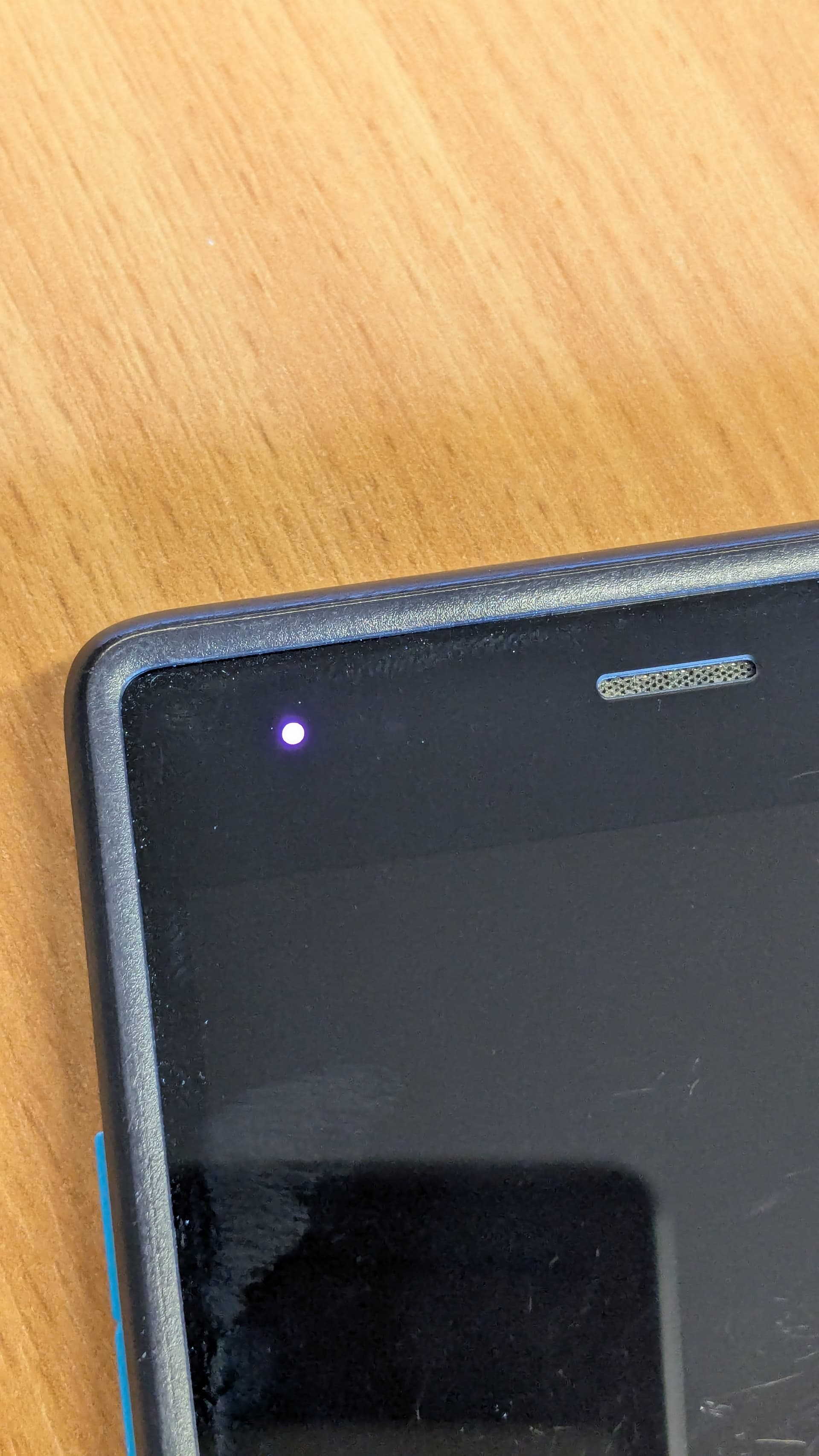

I’ve got an old FP2 which doesn’t boot. I’ve never seen it working, but according to my friend who donated it to me it used to.
I’ve managed to get it to charge and I keep finding it in a state where it won’t turn on but has an intriguing pulsing lilac notification light. It also shows a red and green light when charging and will vibrate briefly if you hold down the power button.

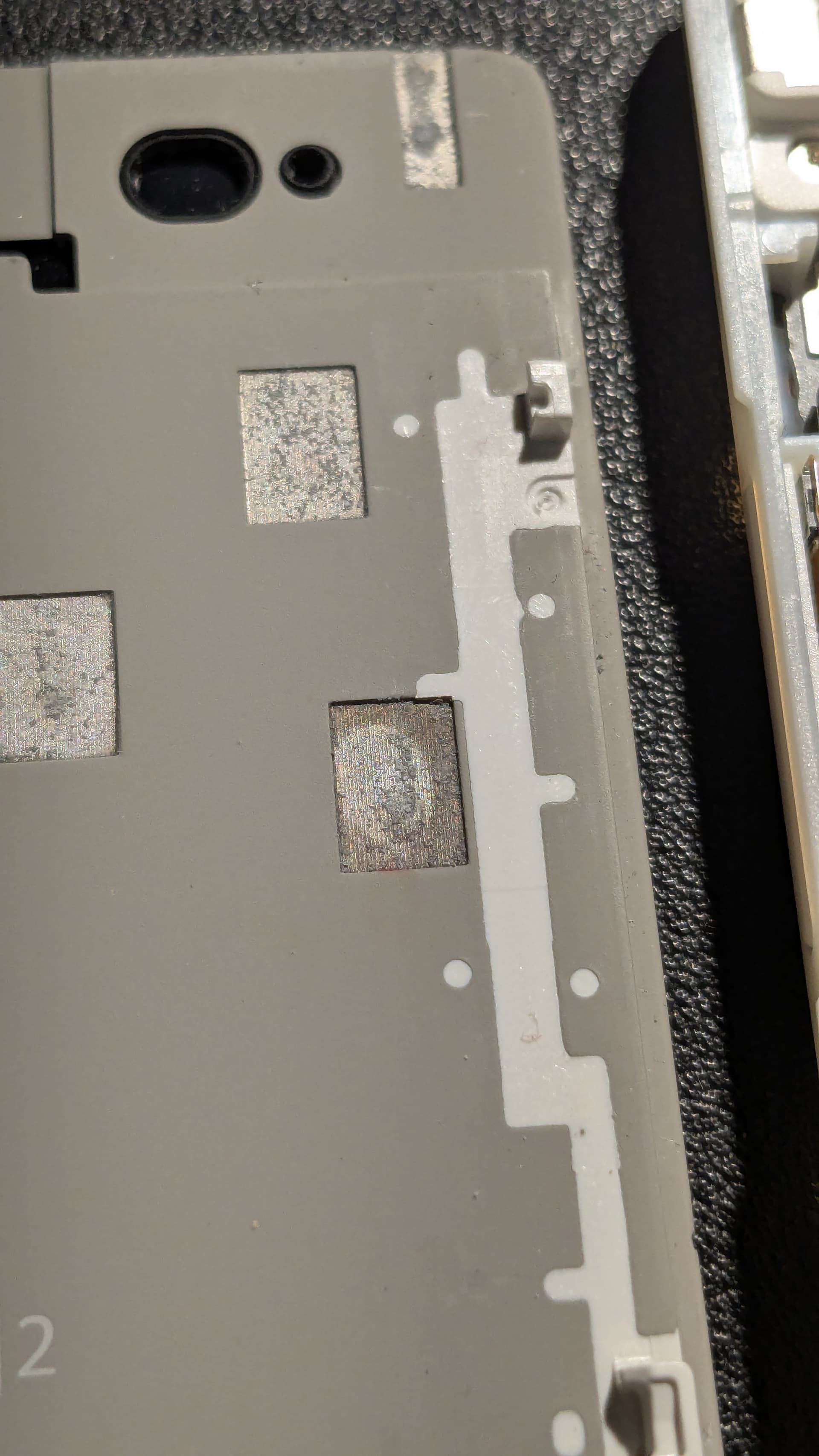

Cheers! I’ve taken it to bits and some of the contacts on the back of the screen do look corroded. So I’ll clean them up and see if it helps. I wonder if some moisture has got in atsome point…
Overall it looks pretty clean inside though.

This one particularly:

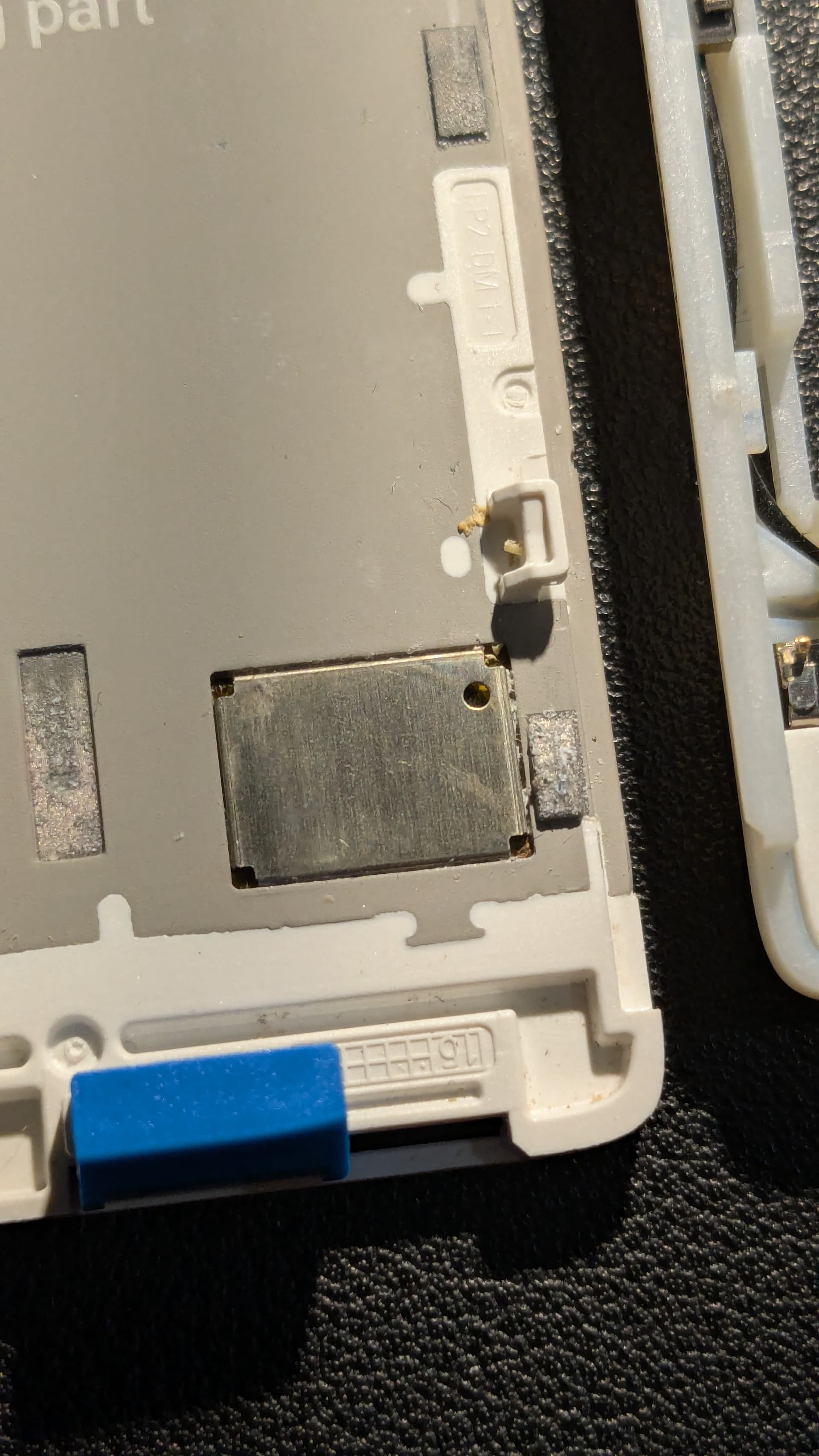

And this doesn’t look great either!
Use high-grade surgical alcohol 90° available from chemists, or isopropanol and cotton buds to clean the contacts. Leave to dry for an hour before reassembling.
