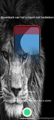

covering the sensors on purpose, the phone wake up after pressing the power button withe a pen (finger will unlock it), i see a warning that pocket mode is actief and will not show the options from the lock screen. as expected.
in the main time the home screen wallpaper shows on the background, bit strange behaviour i will say. I will have expected the lock screen wallpaper or just a black background. the picture is not displayed properly its stretch out. but that’s a different isue wat not really bother me, normal i will not see that screen anyway. the phone is in me pocket.

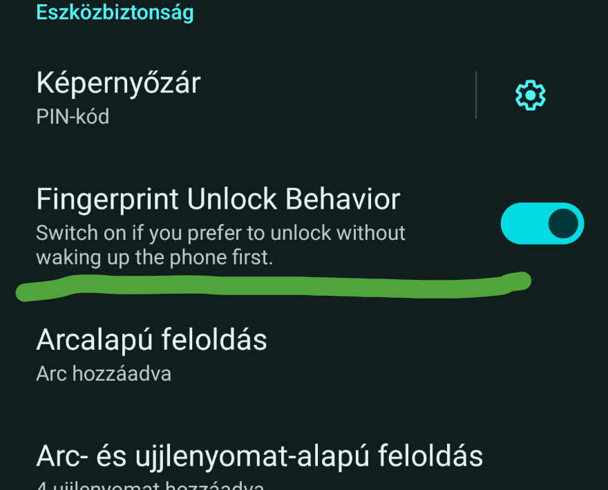

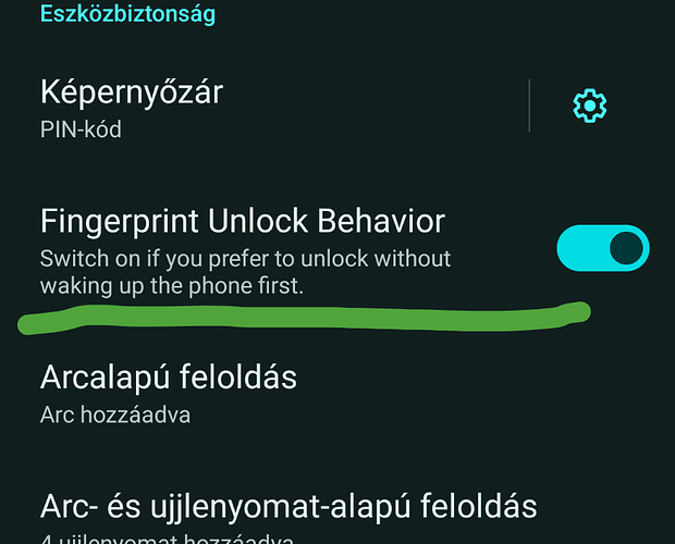

I find this where I can save my fingerprints.
With this setting, only if the display is on the fingerprints unlock works.

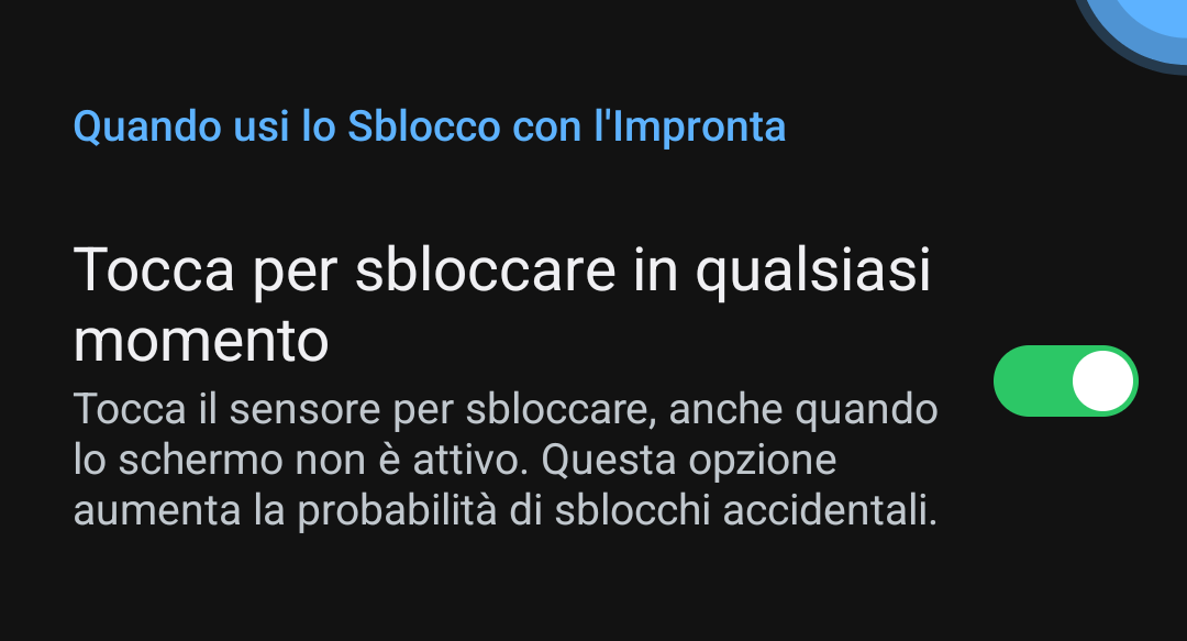

Same on FPOS
For some reason it’s not translated
Thank you @jobal for sharing the setting!
Thank you @Furdiburd for checking it on FPOS and the (kind of) English screenshot!
