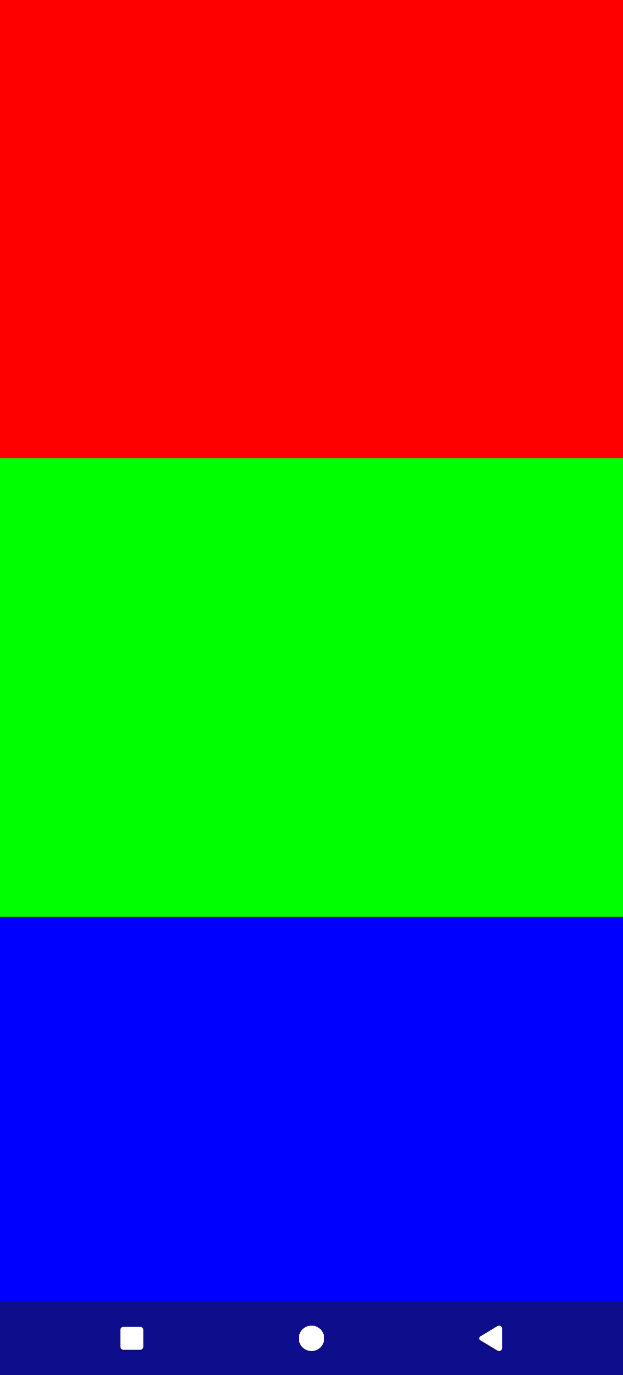

Hello, thank you for responding. File transfer to my PC seems to be completely fine, even when wiggling the cable at the USBC port end. I tried to do the internal test, but it completely stalls out just after the touch screen test showing this. No prompts, touching the screen does nothing and there’s no way of moving it on. I have to tab out just to close the internal test app. I’ve tried twice now and get the same problem at the same point.
I eventually managed to get further into the internal testing by mashing the screen a lot. When I was on the external audio test it was exactly as before with the audio coming out of the headphones when the cable was in just the right position, but coming out of the phone otherwise. The audio coming out was a bit confusing as well as I don’t think it was English, so wasn’t sure how to proceed.
