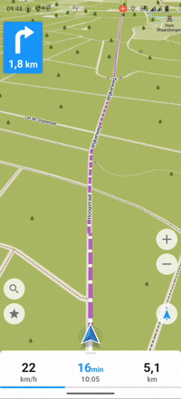

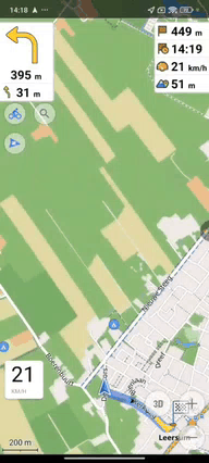

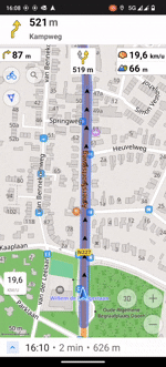

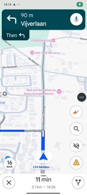

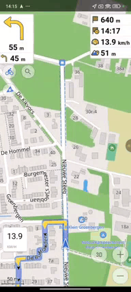

The speedometer in multiple apps:
OSMAnd+
1000044671
OSMAnd.APK (frash installed and on default settings)
1000044672

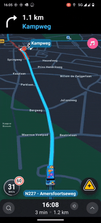

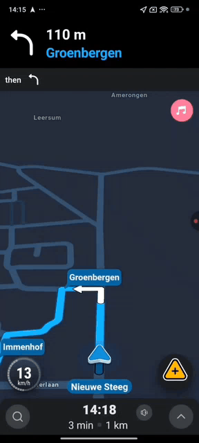

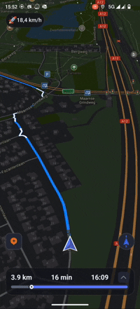

Waze
1000044673
All coming from my Fairphone 5 on FP5.UT2K.B.098.20250109 FPOS
Exactly the same with LOS22.

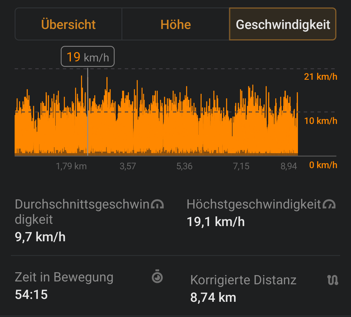

basically, yes. Was that track of yours a bicycle ride or a walk? I’m asking, because I tracked a walk on foot and got a very similar graph as you did, with top/average speeds of (in this case) 19,1 km/h and 9,7 km/h, while in reality walking with 6 km/h at most:
That was the last walk I tracked with the FP5 before realizing that its useless to do so because the values are rubbish. Unfortunately I didnt have another phone with me for reference.

Thats kind of the point. I seriously doubt that I’ve walked almost 9 km in less than an hour. The “time moving” seemed realistic back then, but the distance is probably far off.

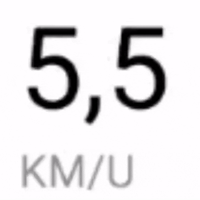

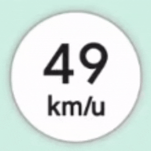

The speedometer in Google Maps:
1000044787 (1)
i noticed this one is wrong as well, only way less noticeable. Google only change the value ones a second.
still sometimes it shows a wrong value.
no average speed but a value each second. most values will be close to reality, just by chance it sometimes take one that deviates a lot.
does everyone see this as well?
video again coming from my Fairphone 5 on FP5.UT2K.B.098.20250109 FPOS
greetings
Tom

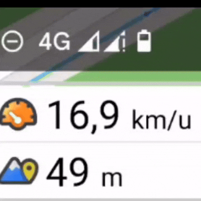

Can you try the Beta version of OSMand?
there should be a bypass for the Fairphone 5 issue be present in the beta version, how is be added especially for Fairphone 5 users, if i dit not get it wrong.
this is only a bypass for the issue when using OSMand. waze and all other apps wil still be as bad as beforem

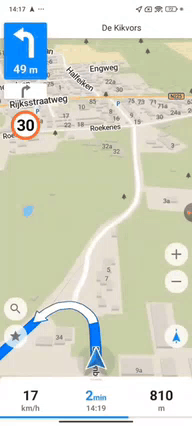

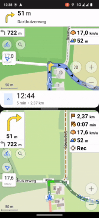

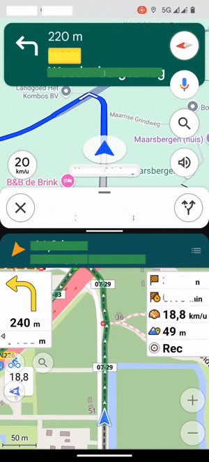

I dit some testing during a bike tour past weekend, running two apps in different settings at the same time.
i see improvement, number jitter much slower, however its not working good enough on my phone to properly use it.
1000045497 (2)
i don’t know how much my settings have influence on the behaviour.
i hade to reduce the amount of Frames in the video to upload it to this form. in reality the difference is beter visible.
top is OSMand bata. not much changed in the setting.
bottom OSMand+ white customized settings.
I’m wondering if other users experience much better results in the bata version.
someone willing to do some testing?
greetings
Tom
Maps. me
1000045572
OSMand+ (Beta)
1000045573
Waze
1000045574
Google maps
1000045576
Organic Maps
1000045577
OSMand (beta)
1000045575 (2)

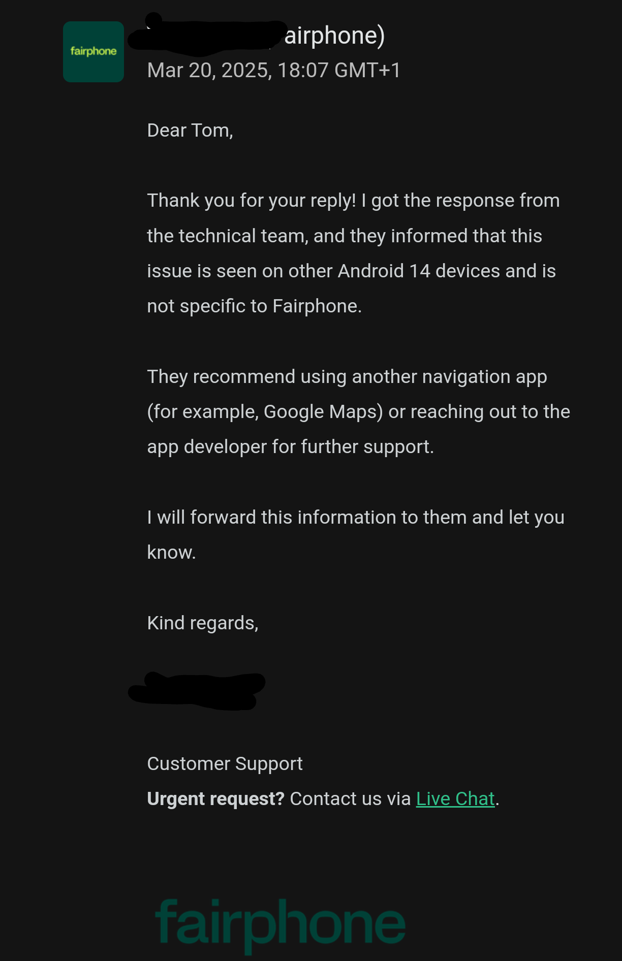

Hi everyone,
i think i’m struggling now to keep my patience.
i just reserved a update for Fairphone, how is telling they still think this issue is pressed on other android 14 devices, not only Fairphone 5.
i thinking about what will be the best response to convince them its not, trying not to rush this.
i guess we can now be more than sure its only present on Fairphone 5’s, please tell me if I’m wrong.
  • ask on which other devices they have observed it.
  • filming other phone brands while navigating using multiple apps.
wat do you think is the best answer?
greetings
Tom
In exactly this order: Ask them for an example where this can be observed, too, then find someone with such a phone and then do the video. It’s ridiculous that they still believe this half a year later…

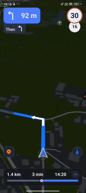

Here we go number one:
Redmi Note 12 pro+
running on: 14 UP1A.231005.007 (android 14)
Google maps
compose_video_1743008040262
Maps. me
compose_video_1743009134517
waze
compose_video_1743009110271
OSMand
VID-20250326-WA0002 (1)
OSMand+
VID-20250326-WA0006 (1)
Organic maps
VID-20250326-WA0001 (1)
Fairphone 5
@Martin_Anderseck
have not received the answer of Fairphone now but we can already add this phone to the list.
