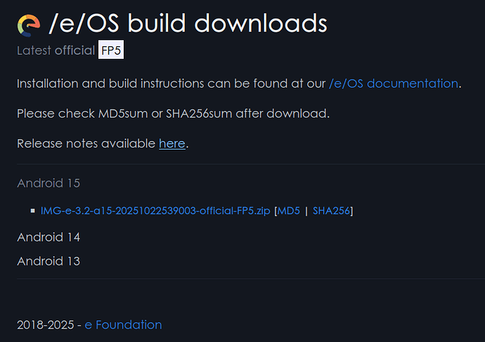

So I would try to install /e/OS. I don’t want to go back to Android. Not even as a temporary solution to try again with the /e/OS installer.
On this website, I find version 3.3 as the latest version – would that be okay or not?

Quick feedback from me:
I waited until a new version was released.
Specifically: IMG-e-3.4-a15-20260117570255-community-FP5.zip
And I used this guide:
After many unsuccessful attempts, everything now works great.
