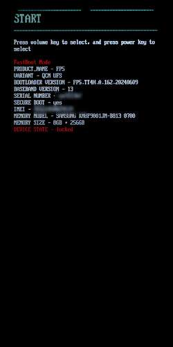

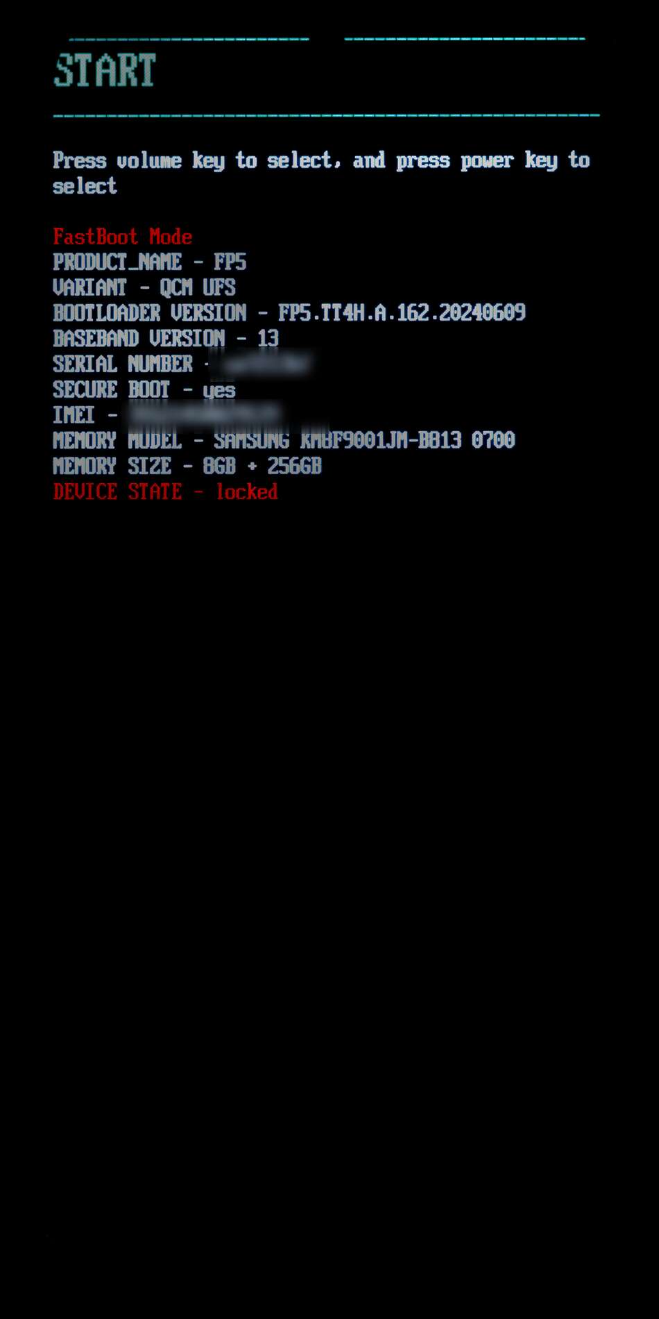

After installing Android 13 and then Ubuntu Touch on Fairphone 5, being scared by the security warning, I locked the boot-loader.
It does not want to boot anymore:
With fastboot I cannot do anything:
fastboot oem allow-flashing
FAILED (remote: 'unknown command')
fastboot flashing unlock
FAILED (remote: 'Flashing Unlock is not allowed')
fastboot flashing unlock_critical
My local reseller in Zurich cannot help.
I have written a message to Fairphone support on Tuesday
but I have not received any reply.
What can I do?
Any ideas?
