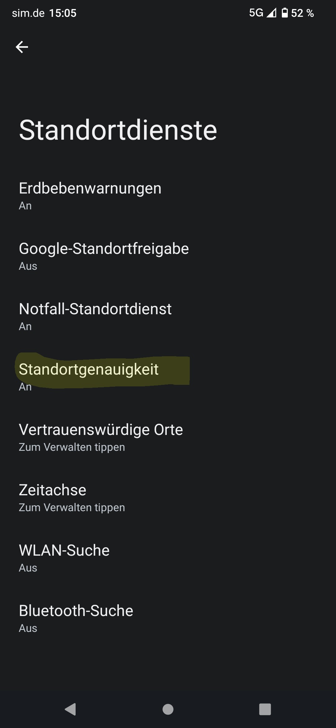

I also have no problems wirh GPS since I agreed to use location services (Settings - Location - Location Services) with the options selected as in the Screenshot ( sorry, only German)
