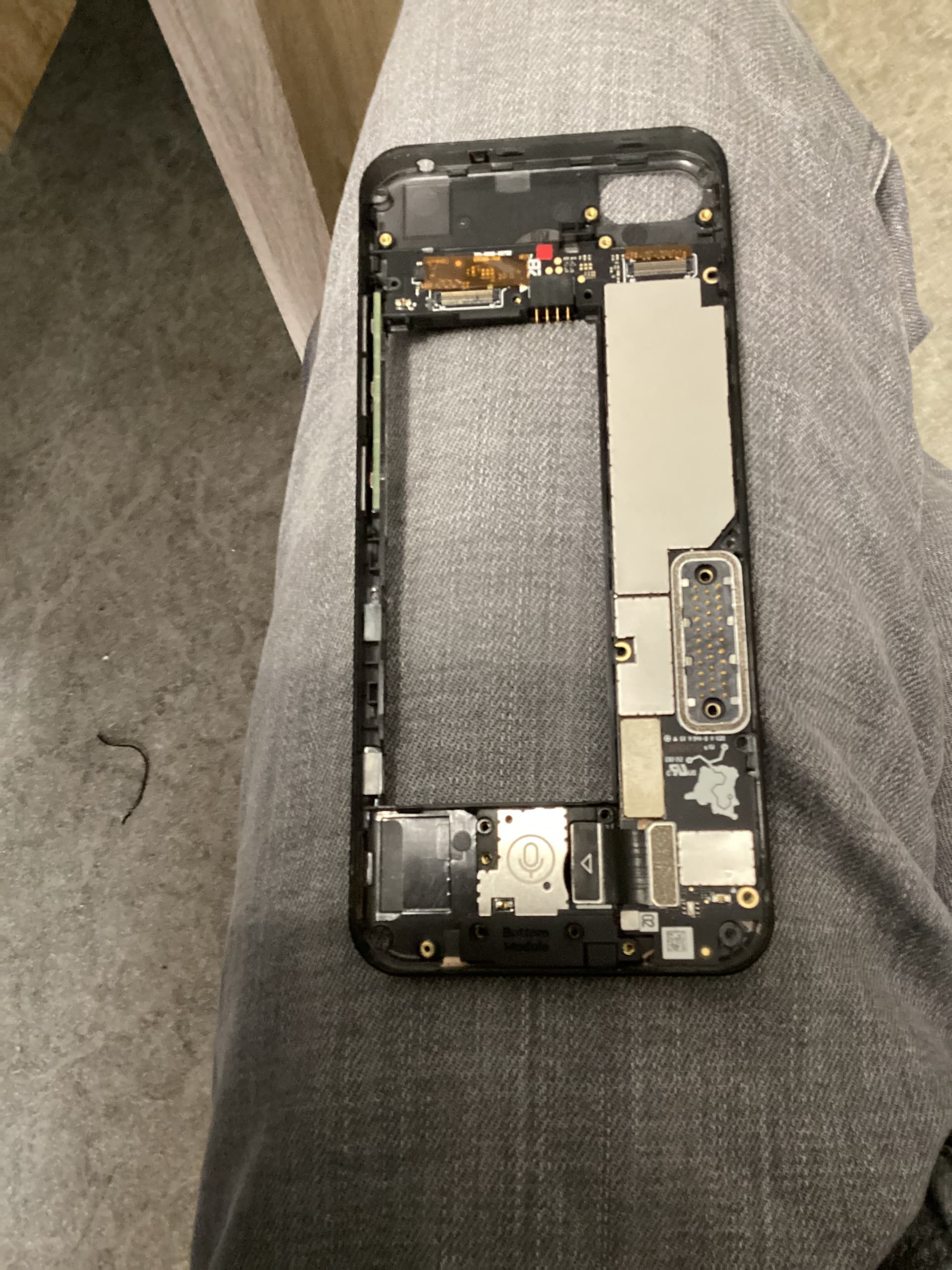

so my fairphone very briefly plunged into the bathtub on a cord and I pulled it out. I turned it off and dried it and it worked. It did not charge anymore and my new battery was already in the mail. I replaced the battery and it did not charge, but ran on the new battery for 4 days before turning off.
I ordered and replaced the bottom module with the same result. My anker power bank tells me circuit protection and turns off.
I disassembled the whole device now and the bottom module alone does not trigger failure. Installimg the bottom module in the now stripped down fp3 triggers it though.
What are my options now?
Full disassemble and reassemble fixed the issue.
