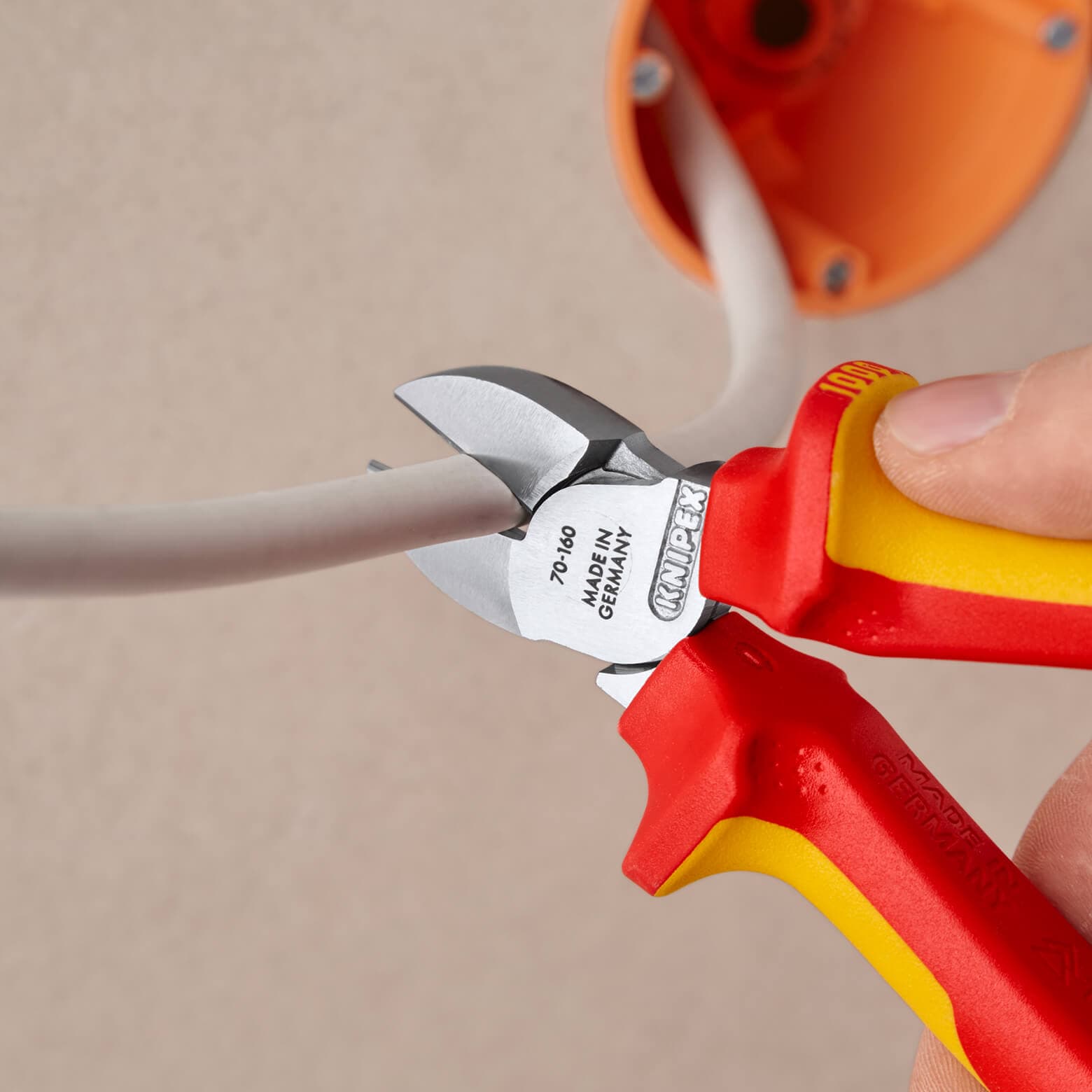

Perhaps a sharp wire cutter/nipper might do the job as well?
Something like this (also available in an ESD version).
Don’t be irritated; the page the link leads to is an english version. :wink: :

Actually yes, I would prefer an easy method like snipping the microphone off. Do any of you have an educated guess whether this would completely break the smartphone or work as intended?

I guess the best starting point is then to try to find the two modules in the giveaway section and order an appriopriate ESD nipper / pincers.

So, I had a little time on my hands, a compatible Bluetooth as well as a wired headset, and all the required tools (see iFixit list & ESD gloves & the ESD variant of the suggested Knipex nipper BertG suggested (64 62 120 ESD, EAN: 4003773025085).

Update: The “operation” seems to have been successful. Both microphone checks via the integrated check up tool failed (as intended ^^). Only a single slight “pop” sound is played back at the beginning and nothing else. I opted for both silver boxes, which actually were covers, as you can see on these pictures. I was not able to put the covers back on.
I simply cut off the most protruding elements and then scratched off less prominent features, until I no longer dared for fear of damage to the whole board. I do not think it would have been possible to cut off the whole component without major risk of damage to the rest of the board. I was wearing protective gear and was inside a well ventilated space.
