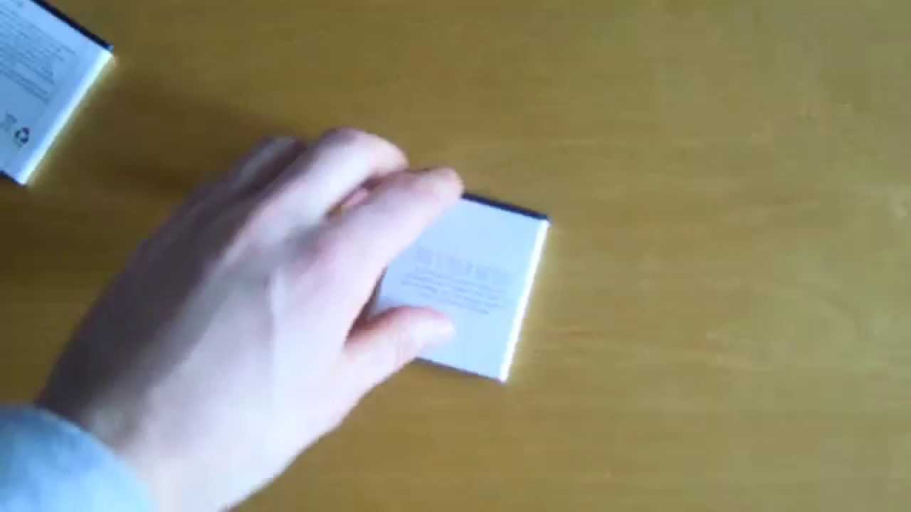

So you haven’t taken the battery out to see if it is warped ?
It could do with checking as it can be a hazzard.
You may want to check out
https://support.fairphone.com/hc/en-us/articles/360018519818-FP2-Swollen-lithium-ion-battery
and
Bingo! You’ve found it. YES, the battery is swelling: It fails the “Spin Test”, I can visually see some swelling, and as a test, I reassembled the phone without the battery inside and the case snapped back together easily and without any gap. That swelling would also, of course, explain the seemingly random behaviours (the various Phases), as it presumably causes poor contact.
