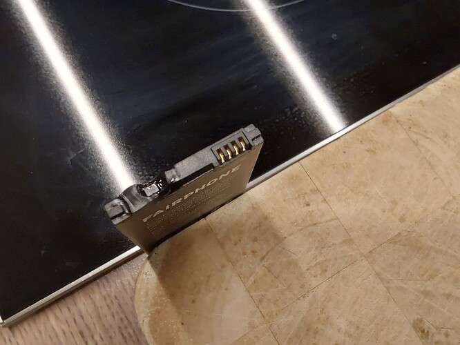

Then I ordered new bottom module and battery. But when I put in the battery, it started to get very hot again, in fact, it started to melt. When looking at the old battery, I also saw some melting happened. See attached picture.

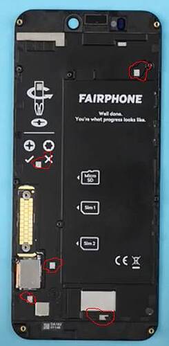

On the attached picture, I indicated with red circles those pads that were corroded. Specifically the one connected to the bottom module looked bad, as does the contact on the bottom module itself that connects to this pad (I can only upload 1 picture at the time)

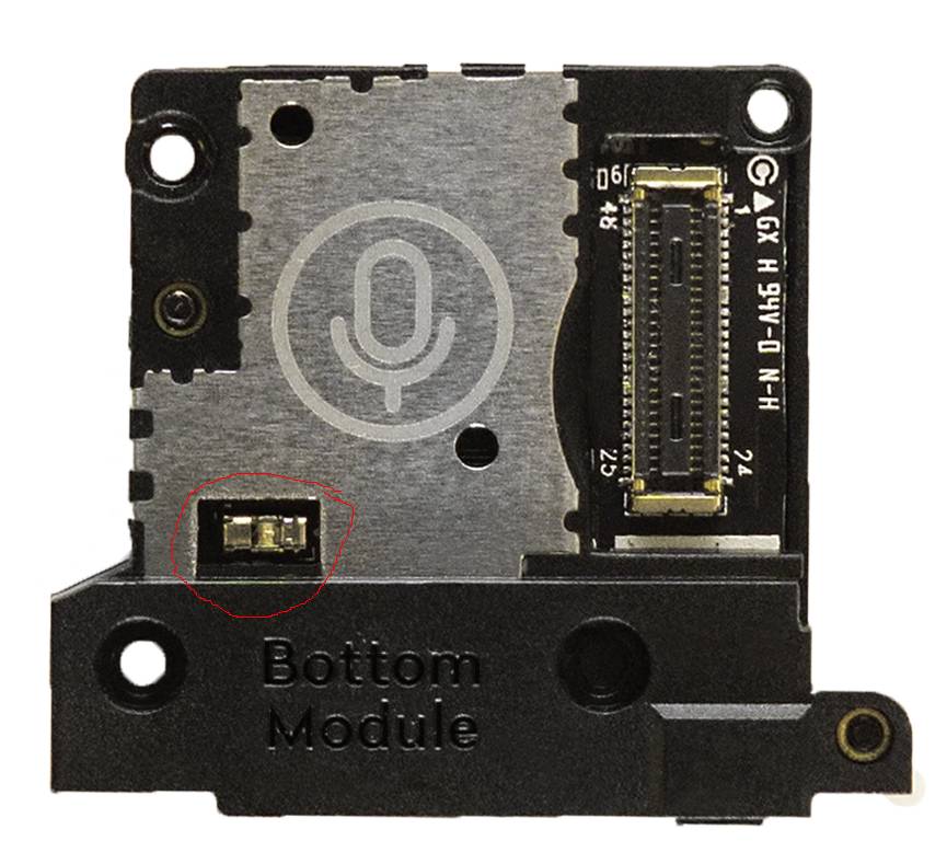

this picture shows the contact of the bottom module that was corroded. I cleaned it in the mean time, but I also replaced the full module. And the contacts to the battery are all clean (forgot to mention that)

By the way, you are right: if the battery is melting it is indeed doing anything. There is really a hole in it now! With dead I mean no LED no vibration, nothing on the display, no response to any button.

a hole? in the battery? My feeling is some electrical short is happening. If you changed batteries and bottom module, it must be the contact with the battery, on the side of the motherboard. this is not good. I’ve never seen that before. Please document it with photos !
Don’t use it, source a replacement. Battery’s protection circuit might have failed.

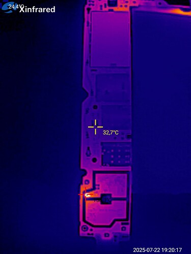

Some update: when connecting the battery to the motherboard only I could see with my IR camera that one SMD component went very hot. I removed the component (it looks burnt), connected the motherboard, bottom module, battery and display and guess what? It boots again. Will save my data and see how the removal of SMD has damaged the functionality

Good catch! It’s a short or, from the looks of it, a capacitor that blew.
It looks like to be around the RF transceiver, so the chip that processes the 4G signals. Maybe you don’t have mobile data anymore?
