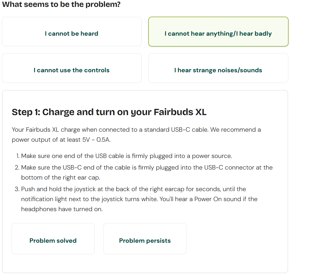

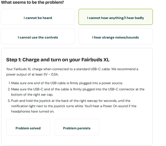

Edited to share the troubleshooting from the website

Yes, the troubleshooting process I linked also suggested checking speakers connectors/cable as a next step - perhaps that is a warranty case?
