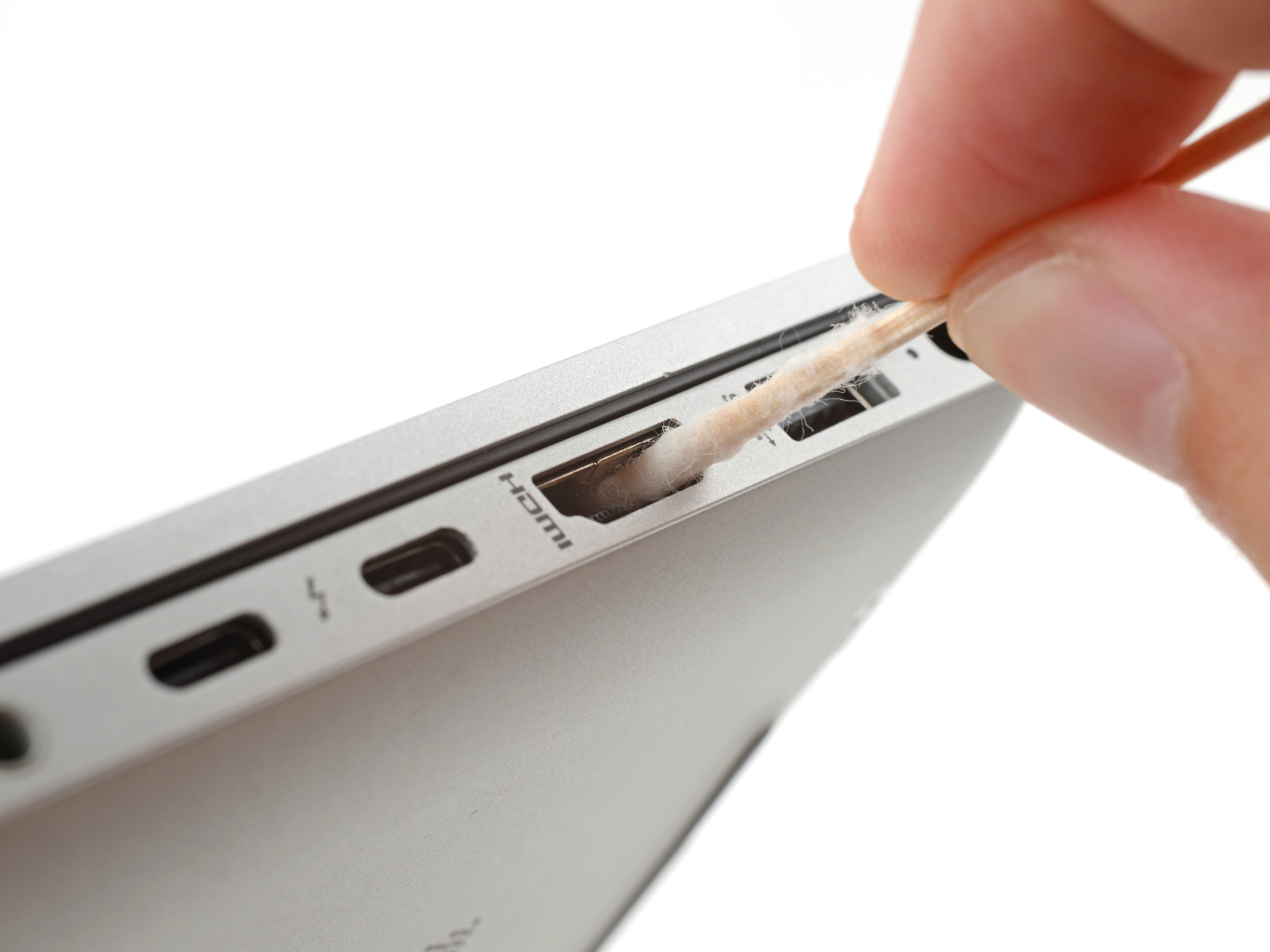

As you have been told, it is most likely the USB-C port. Even if your phone hasn’t been around dust or moisture, it may have been getting it with normal use. Here’s an easy guide on how to clean it:

Muy own experience: I’ve had that problem a few years ago on my FP3 a couple of times, and once I solved it by changing the USB-C cable I was using, and the other time by opening the phone and cleaning the port and connections with isopropyl alcohol:

Update. Cleaned the charging port using contact cleaner and a tooth brush..
