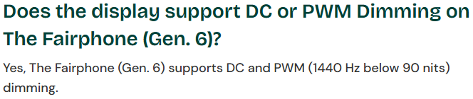

Dear all, according the information from Fairphone’s website the FP6 provides DC and PWM as dimming options for adjusting the brightness af the display.
Unfortunately I can’t find any entry in the (developer) settings in my phone where I can check/adjust this.
I’m on FP6.QREL.15.105.0
Anyone an idea?

For DC dimming I got an explanation
it switches automatically depending on the brightness level. It uses Pulse Width Modulation (PWM) when the display is below 90 nits and switches to DC dimming when it’s above 90 nits. This happens automatically and isn’t something that can be controlled with a manual setting, hence the missing setting.

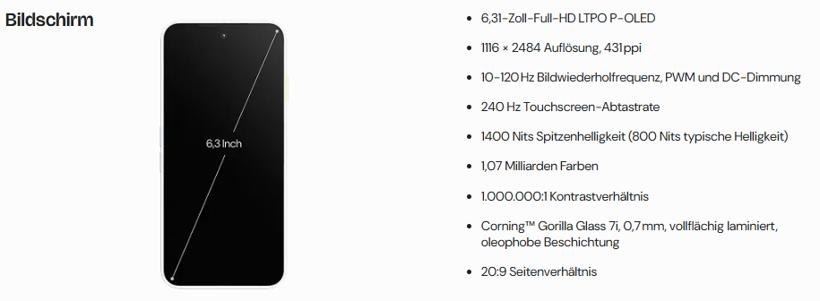

According to this review the FP6 has a maximum of 1400 nits.
Another source stating 800 nits in general use and also 1400 nits maximum.
https://geizhals.de/fairphone-gen-6-horizon-black-a3523215.html
According to my math knowlege I would say 90 nits of 1400 nits would be about 6,4%. in maximum condition.
Under normal condition with 800 nits it would be about 11,2%.
Thanks, so I conclude PWM would be used only at very low brightness levels, DCd most of the time.
