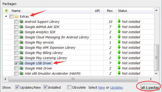

I am on a windows machine so I don;t know if my solution is of any use.
I had a similar problem, I had to install the google USB driver. That solved my issue.
Unfortunately I have no idea how to do this on Linux.
On older Android SDK managers you could findf it here:
Hopefully my info is of some use.
