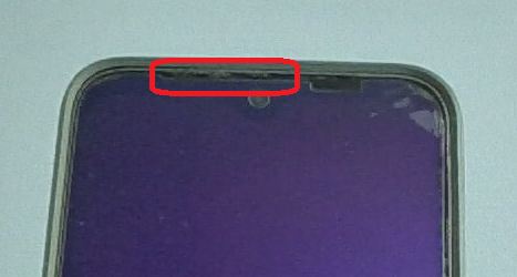

As I now accidentally came across this thread and listened to the above linked piano piece, I noticed that when I put my thumb above the left part of the speaker’s outlet slit on the display, the crackling is reduced noticeably. I could even feel the vibration of the case and display unit. As this reduced the crackling without reducing audio volume much, I was wondering if a piece of tape could provide the same slight pressure that the thumb did?!
So, I used a piece of climbing tape, which I gently stuffed into the left part of the slit with a pointy tool. This reduces the crackling noise but, on the other hand, looks pretty ugly…
But if audio quality goes above anything else, this trick might help you, too.
Fairphone4_stuffed_speaker_outlet
Maybe the same effect can be achieved, if a bit of damping material is stuffed from the inside of the slit when the phone is taken apart. As I did not take the phone apart yet, this is just an assumption! Maybe putting a thin layer of audio foam onto the speaker’s membrane has the same dampening effect?
