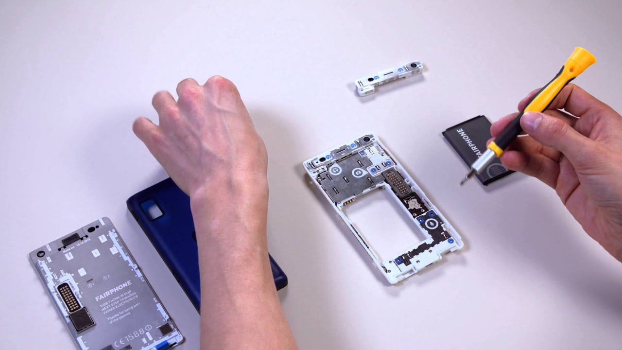

Another possibility is that your bottom module, which contains the USB connector, got loose. You can try to disassemble the module, clean the connection pins, and assemble it again.

For disassembling: You only need a small screw driver, the display comes off without any tools.
Have a look at this:

I can’t even get past the first step in disassembling the phone. I unlocked the two blue safeties on the bottom, but I’m unable to detach the screen from the modules. The video makes it seem easy, as if it slides open. But not even using a little force does the trick for me. I’m afraid to make things even worse if I somehow break the screen or the locking mechanism.

Many people said that taking off the screen for the first time was a bit harder, maybe this link can be of help:
Don’t worry, the phone was built to be taken apart, that’s why you don’t even need tools for getting off the screen. However, since it also is the very first modular phone on the market, it may have some rough edges, which is, that some people reported some problems could be fixed by reassembling certain parts. It might be the downside of this revolutionary design, that in some cases contacts could get lose.
