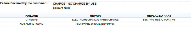

The repair report is not very clear to me:
I guess they only changed the USB port, not the bottom module?
I had the latest software running, so they cannot have performed a software update (and there was no release during the time it was at their repair center). I guess they just reinstalled it
No other comments about any checks/ what they did
