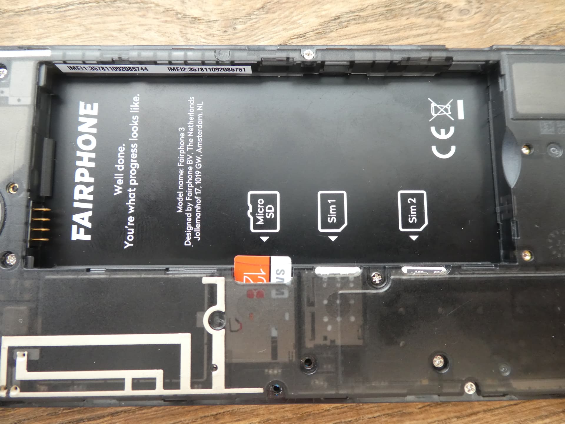

I have just taken a pic to show how far I can insert the card before it reaches some sort of stop. You will notice that I have removed two of the screws in hopes that it might allow something to line up. It didn’t.

I am not sure if you are inserting it the right way. When you insert it, it should be directed in a way ressembling the shape of the Micro SD symbol next to it.
Maybe it needs to be inserted with the writing on the backside?
UPDATE: Ah, nevermind. I compared with my own (Samsung) SD card and from your picture it seems that you did it all right.
Hi Nick
a) can you fell the spring when you push it in, your picture shows about how far it will go before you have to push against the spring.
b) I don’t know whether it’s the angle of the picture but all the cards seem a little out of line,
c) You definitely shouldn’t have to remove any screws to see if that helps.
Do you know anyone else with an FP3 that can assess if the spring is just stiff or there is something wrong? and
how long have you had the phone as clearly Fairphone will want to know as soon as possible if it is a manufacturing fault. #fairphoneangel

I agree, Amoun. The cards do look a little out of line in the picture. Both Sims are working fine. It’s just the SD that won’t go in.
There is no indication of pushing against the spring. I am coming up against a hard stop.

Are you sure that is a standard micro SD card as they have a ledge/flange on the top outside edge so you can pull them out of non spring type slots .
Here’s a picture to show what I mean }~ to the right you can see the extra height. Maybe you could also take the SD card out an show it in it’s totality. I’ve this weird idea that it’s not a standard SD card. Is the shape the same i.e. it narrows at the insertion end, if not it won’t go in and definitely is the wrong sort of card, and I’ve never seen another type.
PXL_20210828_191941669
Actually when I look at the image of yours more intently l think I can see the raised edge. Oh well!
One other thought where did you buy the phone, from the Co-op or a UK based shop as you could take it there/back to be looked at.
