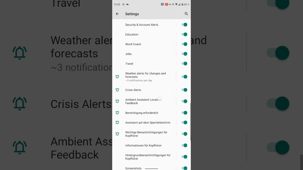

I made a short video:
In the video I’m opening the notification settings (0:14), enter the sound settings and switch from “None” to “Adara”, to prove that this works. After that i switch back to “none” and the setting is back to “Default notification sound”.
