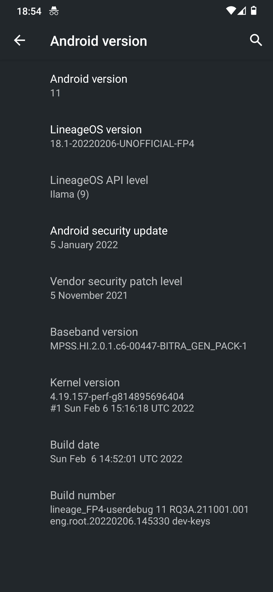

I just built and signed the build using this docker image. Just put this in your manifest file:

This build will include microG and fdroid, as well as the privilege extension thingy to make fdroid able to install apps without asking a million times.

btw, this build was made with test keys. I have another one with custom keys, but I’m concerned about migration whenever an official upstream build becomes available, so I didn’t upload it (also signature verification needs to be bypassed when installing from recovery, and I’m not sure how to fix it)
