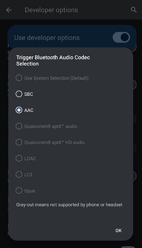

Could you please go to device settings and share which bluetooth codec (AAC or SBC) your device is using? Could you please test with both and tell us if it makes a difference?

Where to find the codec the device is using? (I have a FP5 with iodéOS - right now 5.1 → Android 14 btw.)
@Smojo When I connect the bud(s) the same menu from your screenshot (from the Android developer options) lets me choose between SBC and AAC. So I’d assume that at the time when you took the screenshot they were not connected to your phone?
You are right. When connected it seems AAC is selected first (/per default?) at least here.
