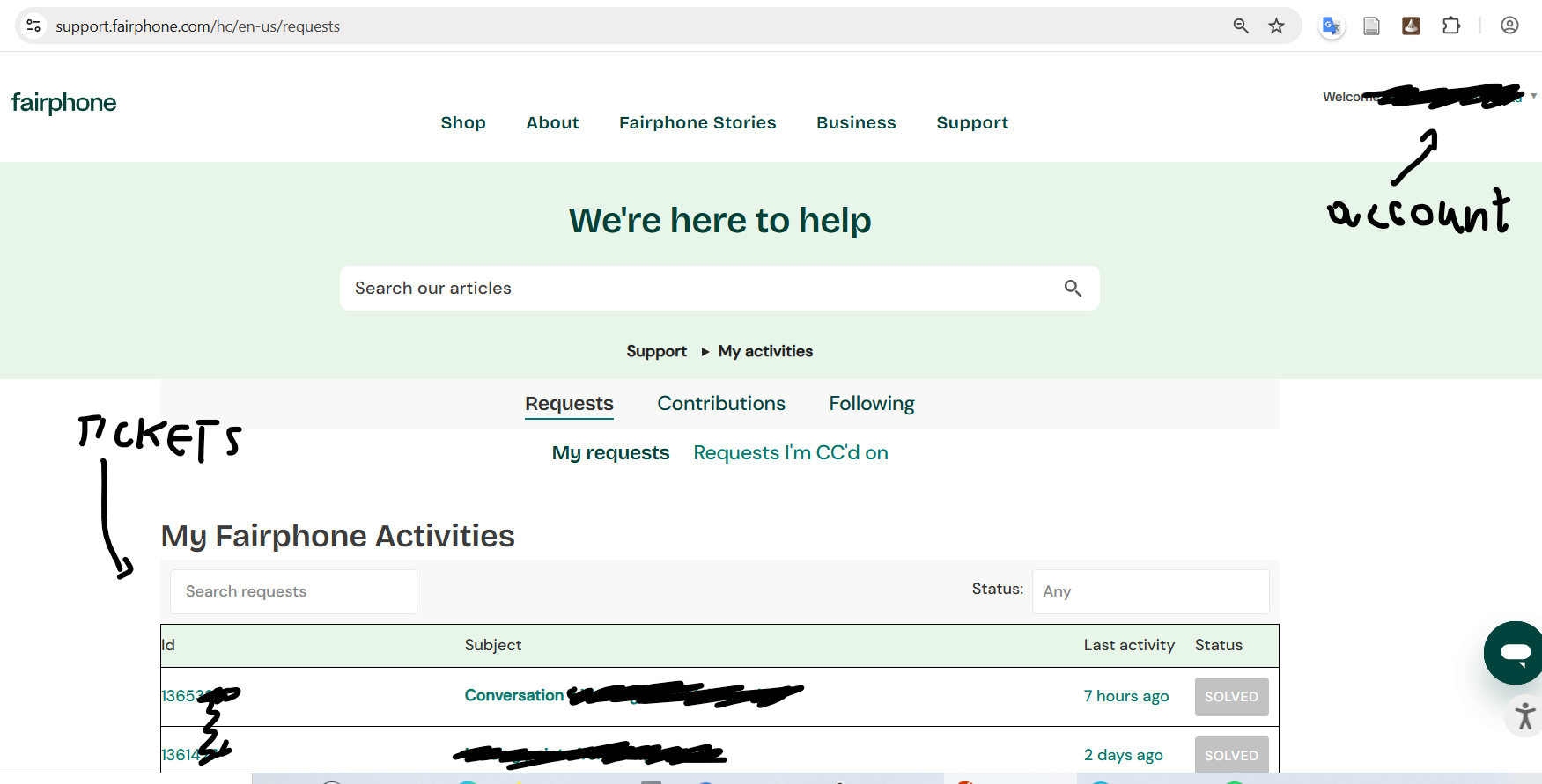

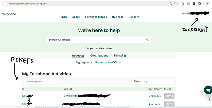

Tracking the repair - if that is what you meant - looks like that, and is hosted at the troubleshooting portal
Tracing the tickets looks like that, and is hosted at the support.fairphone.com
