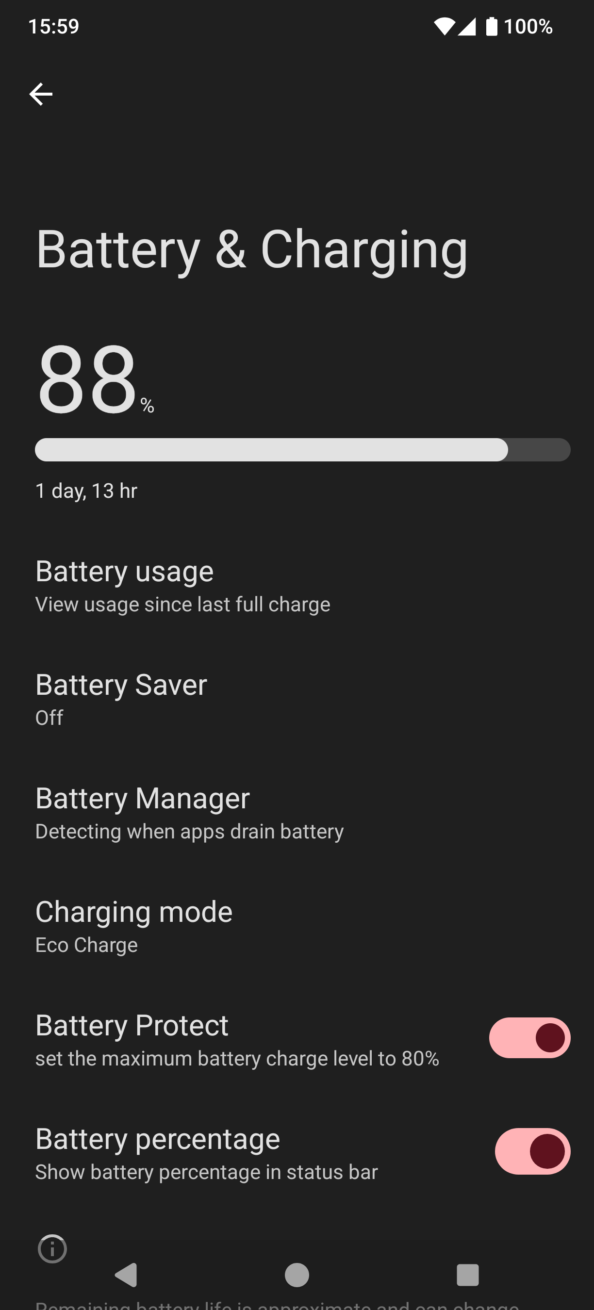

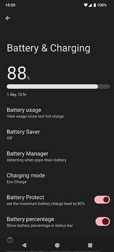

Here are some screenshot of what this looks like, while the phone was NOT charging:
“?” as battery status:
In the top right it says 100% while at the same time, below it says 88%, indicating a sudden jump just a few seconds ago:

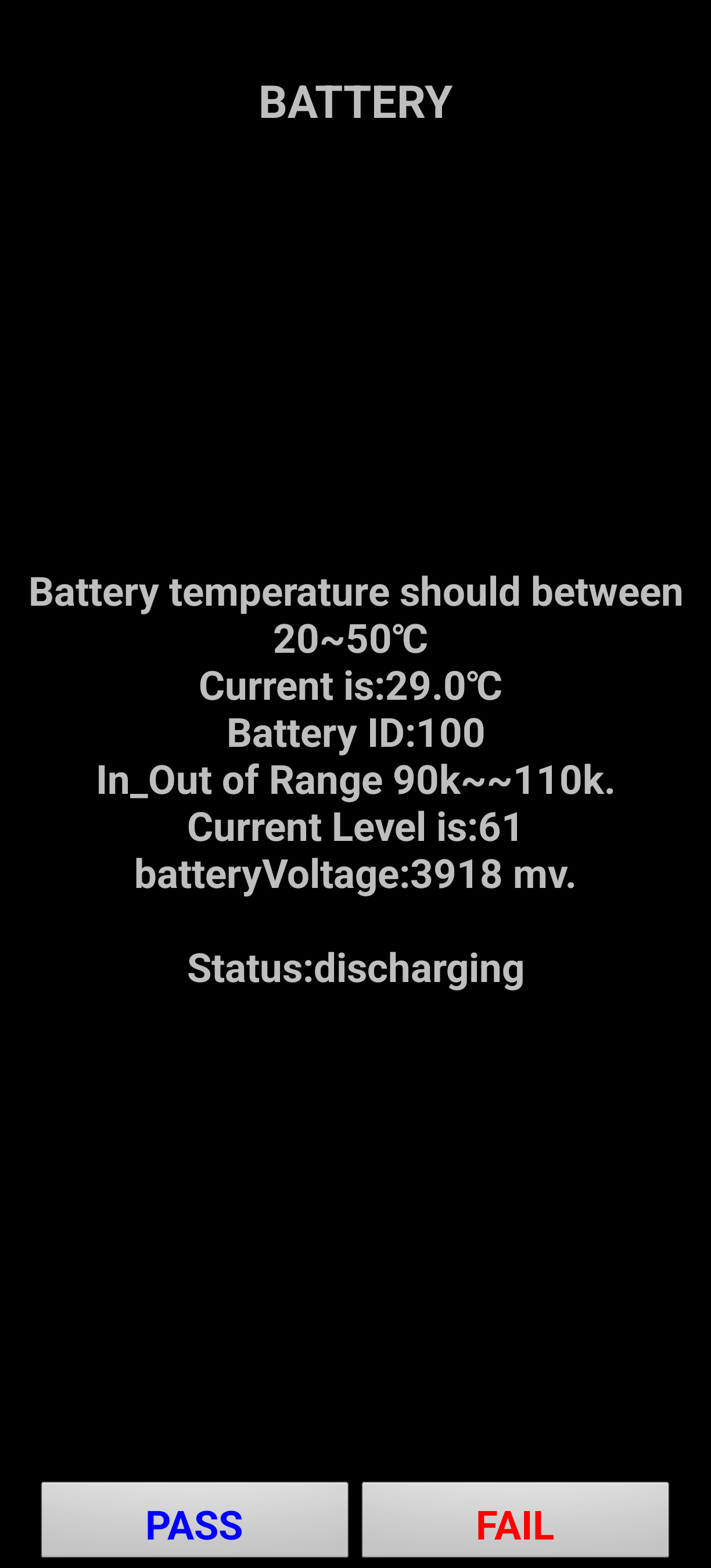

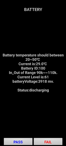

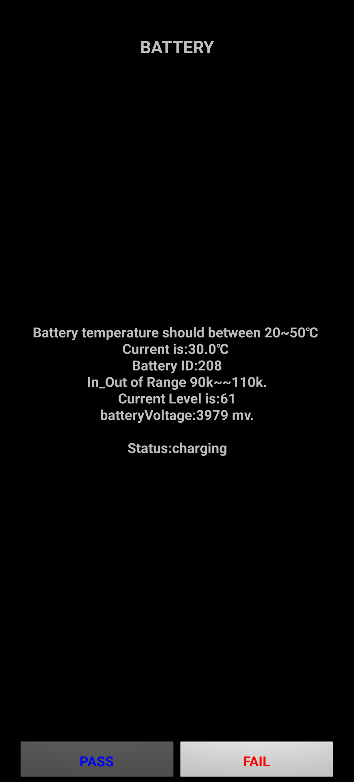

If you have a local Angel nearby you might try to see if they have a battery to check. Otherwise you might consider ordering a spare and seeing if it makes any difference. There is some internal testing available for battery, that is my result (for my second newer battery that I use for travels)
If is hardware, and you would need to send in the phone, now is the last moment for full backup:)
Below are screenshots of the results of my battery test:
Strangely, I cannot press the “PASS” button. I don’t know why.
Charging:
Discharging:
