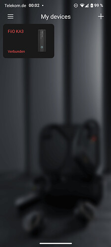

I have a FiiO KA3 DAC connected directly via USB-C. No Problems with the output gain but a really quite annoying bug:
Can you confirm your FiiO App is recognizing your not-working DAC like it’s shown in my app?
I would give that a chance: Maybe it could be necessary to install a new FW via another smartphone if provided by FiiO. I’m not sure it’s only a cable-related thing. I guess the overall chain of FiiO DAC/Cable/FP HW/Android Audio Stack (…) can be slightly fragile.
