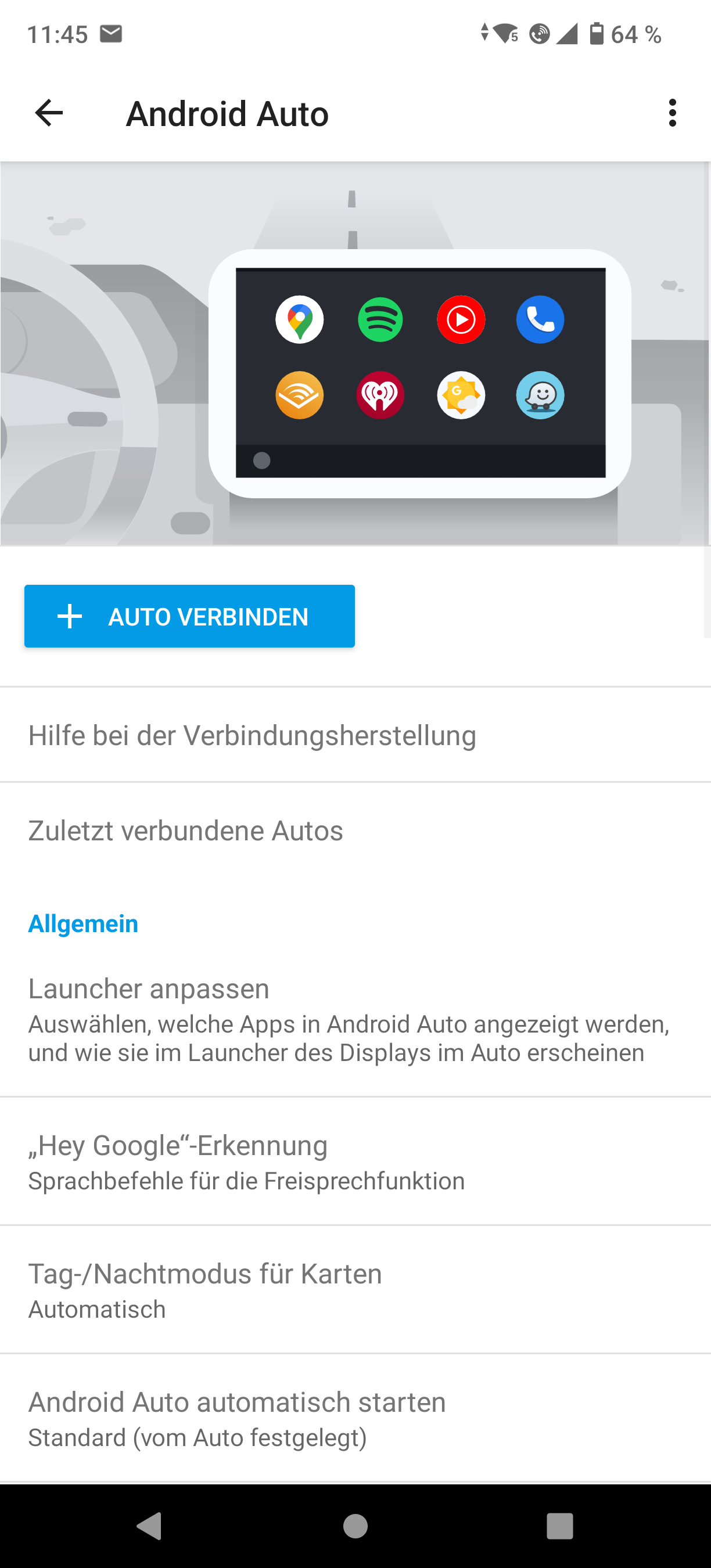

Settings-Apps
However for settings of Android Auto search for Android Auto in the settings

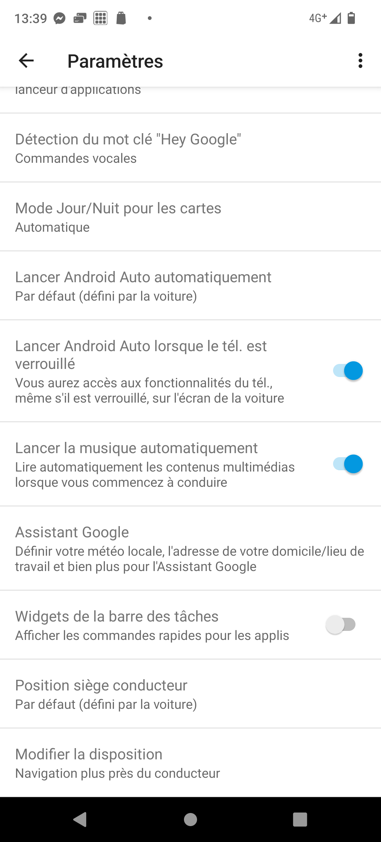

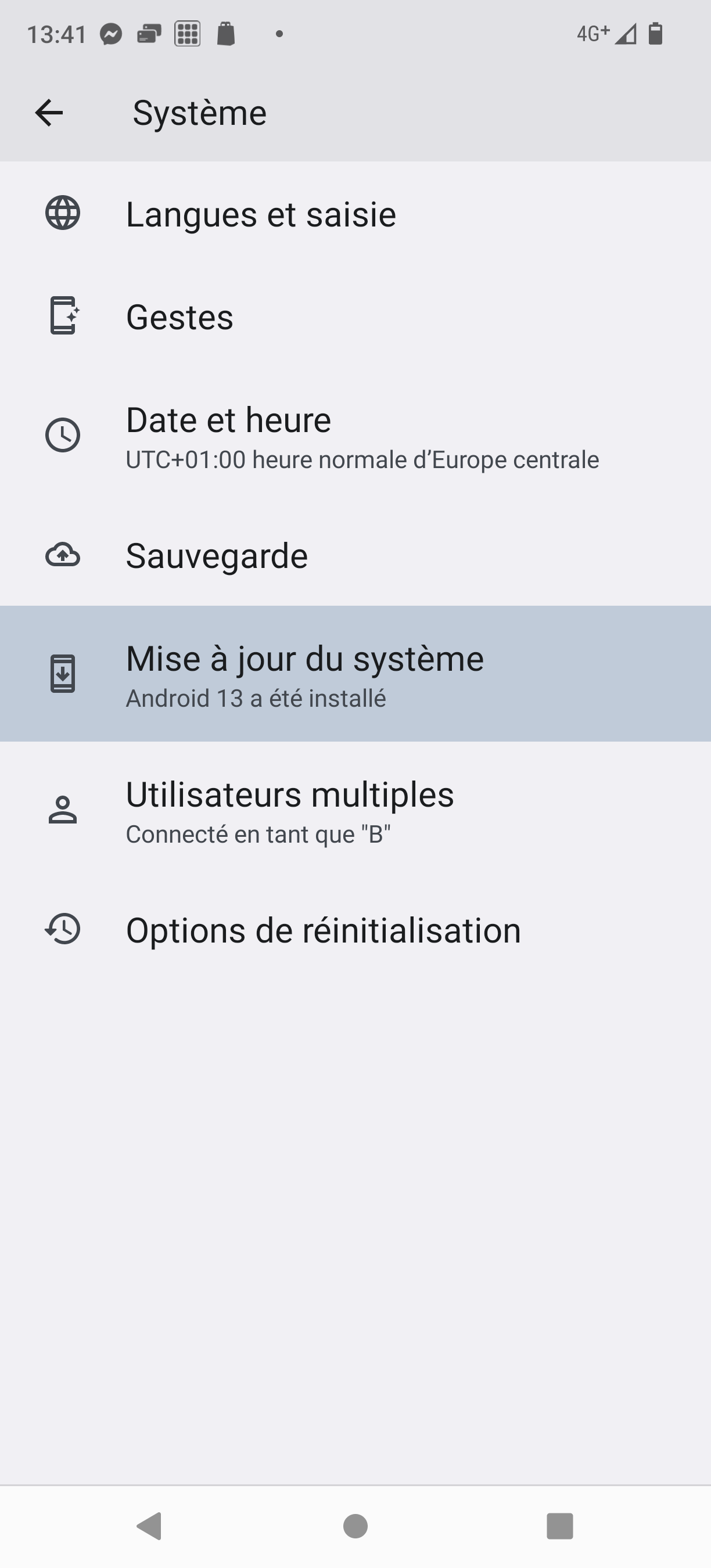

Thanks unfortunately it doesn’t work…
All seems ok but when I plug the cable it only load the battery
