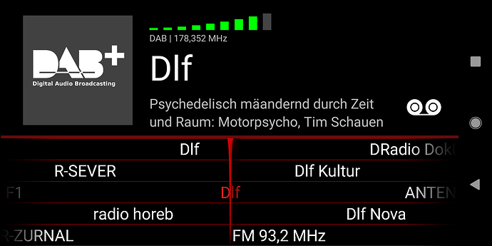

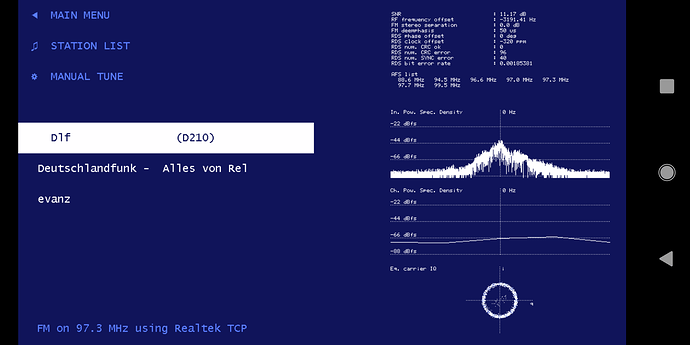

Of course it works, I tested it with both the FP2 and FP3.
What you need:
  • Your Fairphone
  • An USB-OTG adapter
  • An USB DVB-T stick
  • An antenna
  • The SDR driver app.
  • The Wavesink app (€ 12.90).
Wavesink will look as follows:
You don’t need root or an external power source.
Advantages:
  • You retrofitted an FM radio to your phone.
  • It provides an auto-scan feature, but you can also manually tune into frequencies.
  • RDS is supported.
  • It has not only an FM tuner, but also a DAB tuner.
  • It shows a lot of technical information you won’t see on most other radios (like the RDS PI or the AF list).
Disadvantages:
  • The USB stick with the antenna is not suitable for your pocket.
  • The reception is not as good as with a dedicated radio (even pocket ones).
  • The battery consumption is quite high, especially with the FP2, and you cannot charge while listening.
  • Wavesink’s UI is not beginner-friendly.
