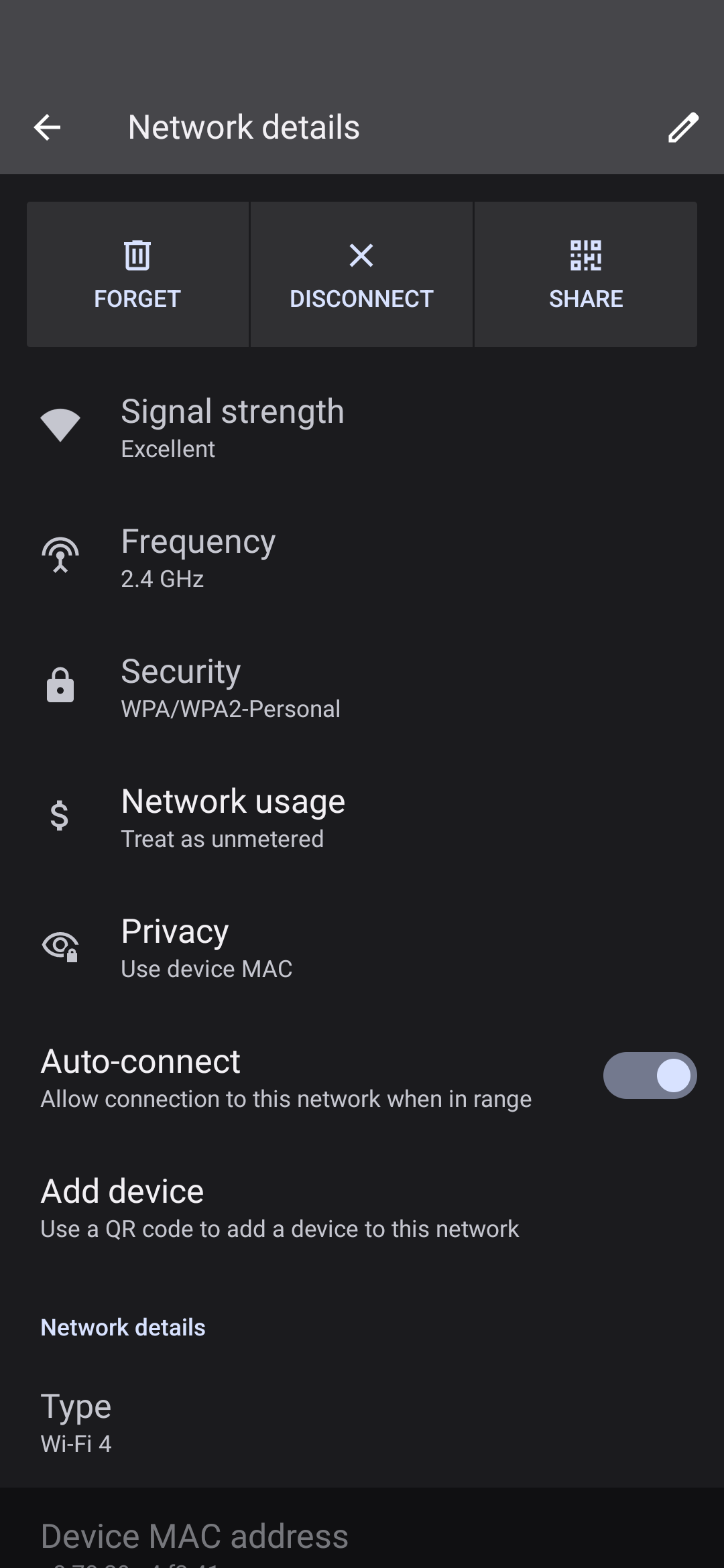

I saw your other post too. Are you experiencing this problem with all the Wi-Fi networks you attempt to connect to, or only your own private network (presumably at home?) If you are experiencing problems with all networks then I would advise you to #contactsupport
To take this further, could you indicate make and model of the router.
Could you set your router to automatic (default) configuration and post as much information as you can about the network characteristics: channels, frequencies, typical signal strengths, security (except don’t include private information such as SSID and password). I’m particularly interested to hear the security options being offered by the router (such as WPÄ3, WPA2, WPA, WPS, …) Also the use (or not) of TKIP.
I would recommend setting the router to use WPA2 or WPA3 without the possibility of using TKIP which in the past I have found to cause problems and which is deprecated anyway.

I did an additional check on the used channels in 2.4 and as well in 5 GHz. My Router is currently the only device which offers a 5 GHz connection. But the Fairphone is still not able to use it. So it looks like that the Fairphone is not able to connect to 5 GHz at all.
I’m not very surprised the SSID separation didn’t help.
As already stated above, it sounds to me as though there is some problem with the phone itself. Other FP4s function perfectly well with both 5 GHz and 2.4.
This might also indicate that there is some problem with the security. I’ll give it some thought, but I think you would do well to contact official Fairphone support. contactsupport
