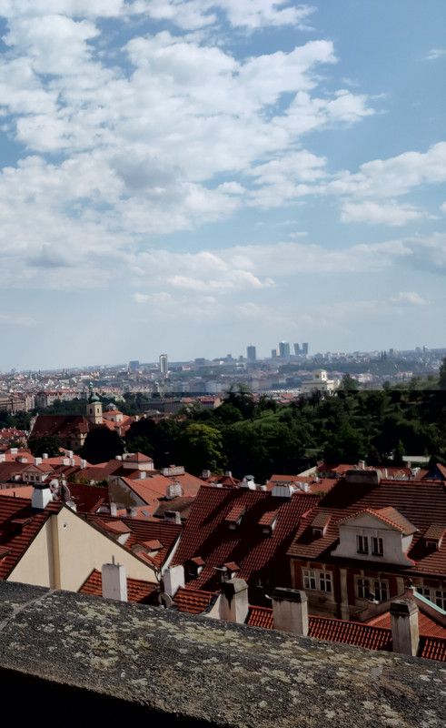

Hey, so I have these weird artifacts on some (6 out of 84) pictures It’s best to just look at the ones below.
Here are some facts:
- It’s happening regardless of hardware, so it must be an issue how the data is saved or maybe even because of the heat.
- It happened on either of the cameras (selfie, normal and wide).
- I used the standard photo app, my phone is running on Android (not /e/OS) that it has been shipped with, on version 12 (Build number FP4.SP2G.B.079.20230624, I’ve not updated it since taking the pictures)
- Some were also done on high pixel
- There’s always a little additional artifact on the left side, which is content from the right side. It’s only visible on some pictures, because I couldn’t crop it that way (visible on 3, 4 and 6 though)
- Sometimes the artifact is only visible on the thumbnail.
- Sometimes it’s gone on the Fairphone, but if I open that same picture on another device, it’s there
- It looks like there was a delay between the parts of it, because the difference is not only in color but it’s also crooked, which is visible on some pictures
- I’m leaving the EXIF-Data in as much as I can, but I can’t give you originals and I have to crop them, because those are still private pictures
- Opening them in GIMP also gives me error messages of this kind: “Corrupt JPEG data: 75 extraneous bytes before marker 0xd9” with the number of bytes being different, the marker is the same
- I only cropped them from one side.
