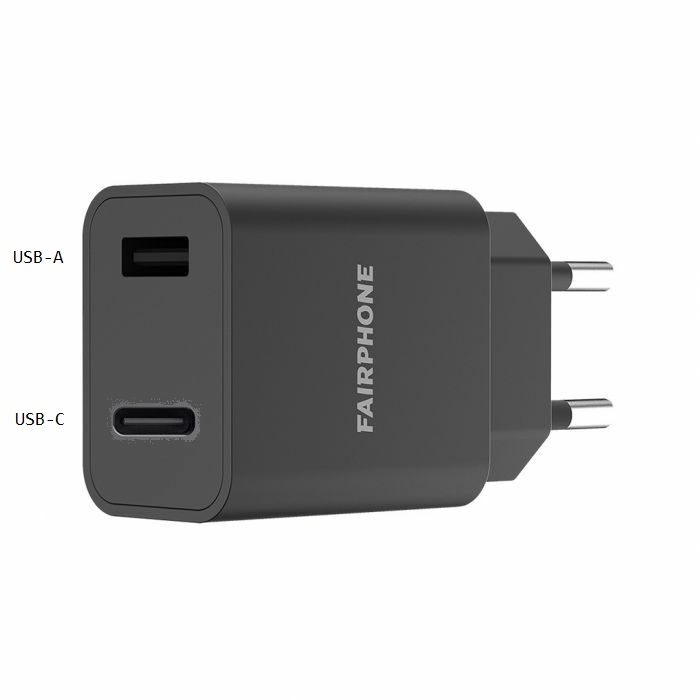

Well, look at that. I guess this wasn’t such a bad idea after all…
I wanted to post that here already, but couldn’t find the thread, I didn’t search for ‘plug/adapter’ but ‘charger’
