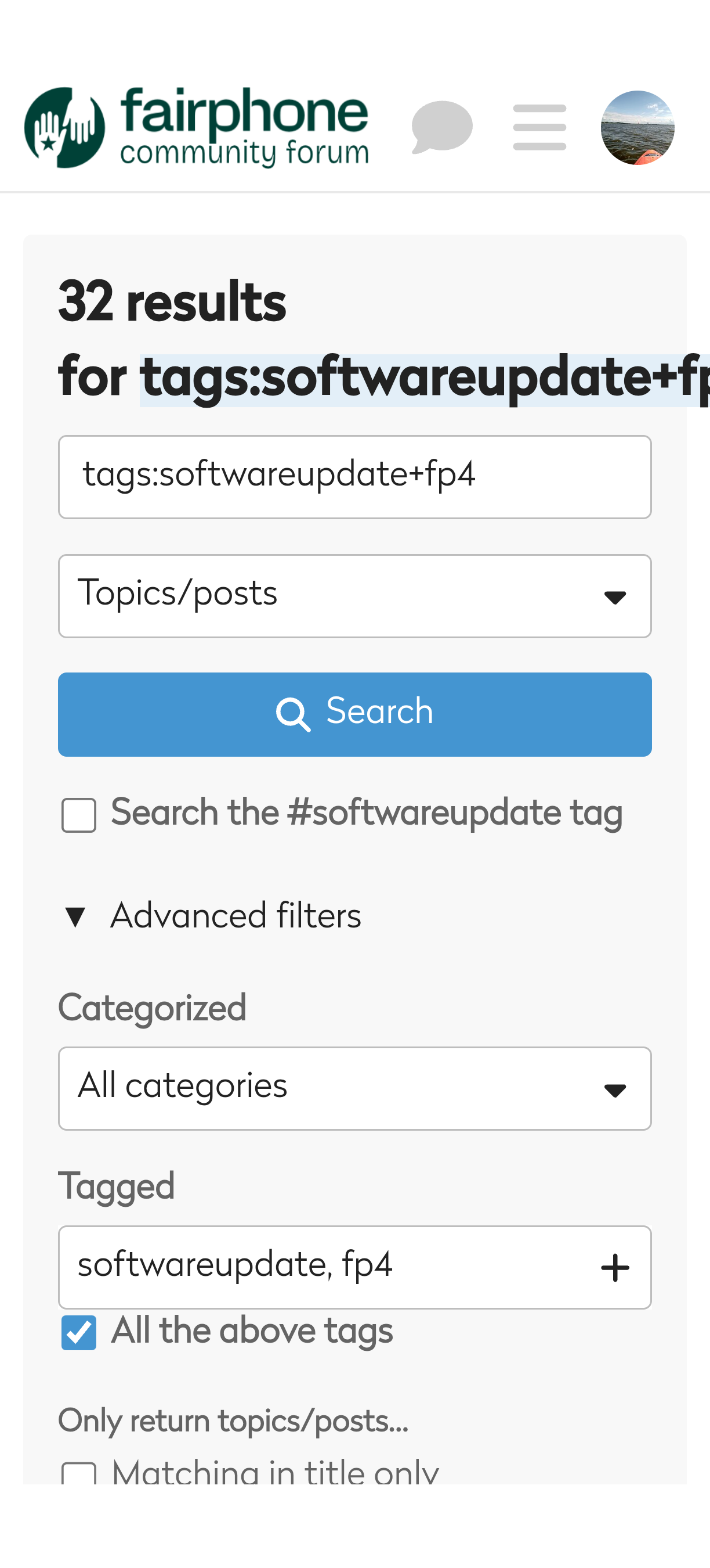

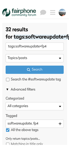

I would like to understand how android updates are performed in the Fairphone world. I’ve read a few things but that does not answer my questions - perhaps those contents were too general, not preceise enough, or my knowlege and understanding are insufficient.
Apparently, there is also a so-called google play system update, but that doesn’t seem so critical to me (my FP4 seems to be up to date on that level).
So what interests me most is the so-called “security update(s)”.
First of all, does the phone first propose to you the oldest update you would have to do?
Or does it propose to you the most actual update?
Do security updates imply that you might get a new version of android installed?
Depending on the answers and my understanding, I might have more questions - but I’ll pen off for now.
