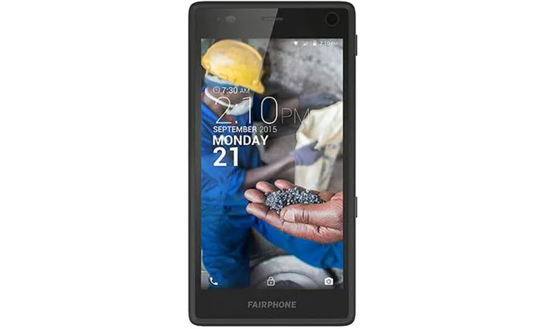

Has anyone tried one of these?
Do they enable support for encrypted userdata?
Reading and backupping encrypted files with TWRP on the FP4?
The first link at least seems not reliable, the picture is FP2 and the specs are the ones of FP3 :rofl:
The Fairphone 4 (FP4) features the specifications Chipset Qualcomm SDM632 Snapdragon 632 (14 nm)
These links look like the ton of auto-generated content you can find on the web.
The device article related page is automatically filling a template with [device_name].
Generally speaking for the FP4, I’d say given the amount and the quality of the passionate people on this forum, if any method to do anything is somewhere, it’d be here. Even XDA forums can’t compete. So I’d have some doubts towards any information provided in random android blogs :smiley:
