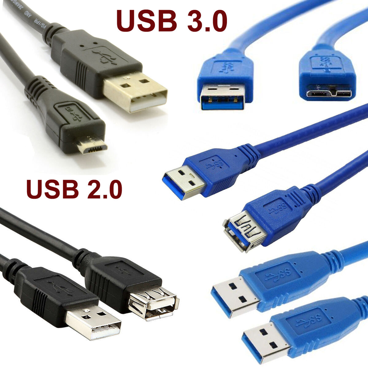

what steps would I need take to determine this?
I’d say toggle between different ports and use a different cable. This is based on the mentioned posts, other users report changing and having success. USB ports are a world in and of itself, there’s different bandwidths, power directions and capacity… etc. I think I used a USB 2.0 port (the one with the grey / white flap) but other users seem to report success using USB
3.0 (the one with the blue flap). Users that had issues usually went from the 3.0 one to the 2.0 one. Usually 3.0 ones are at the front part of computers (for data devices) and 2.0 ones are at the back (for things like keyboard and mouse, that don’t need the increased capabilities).
Here are two pictures for further reference:
