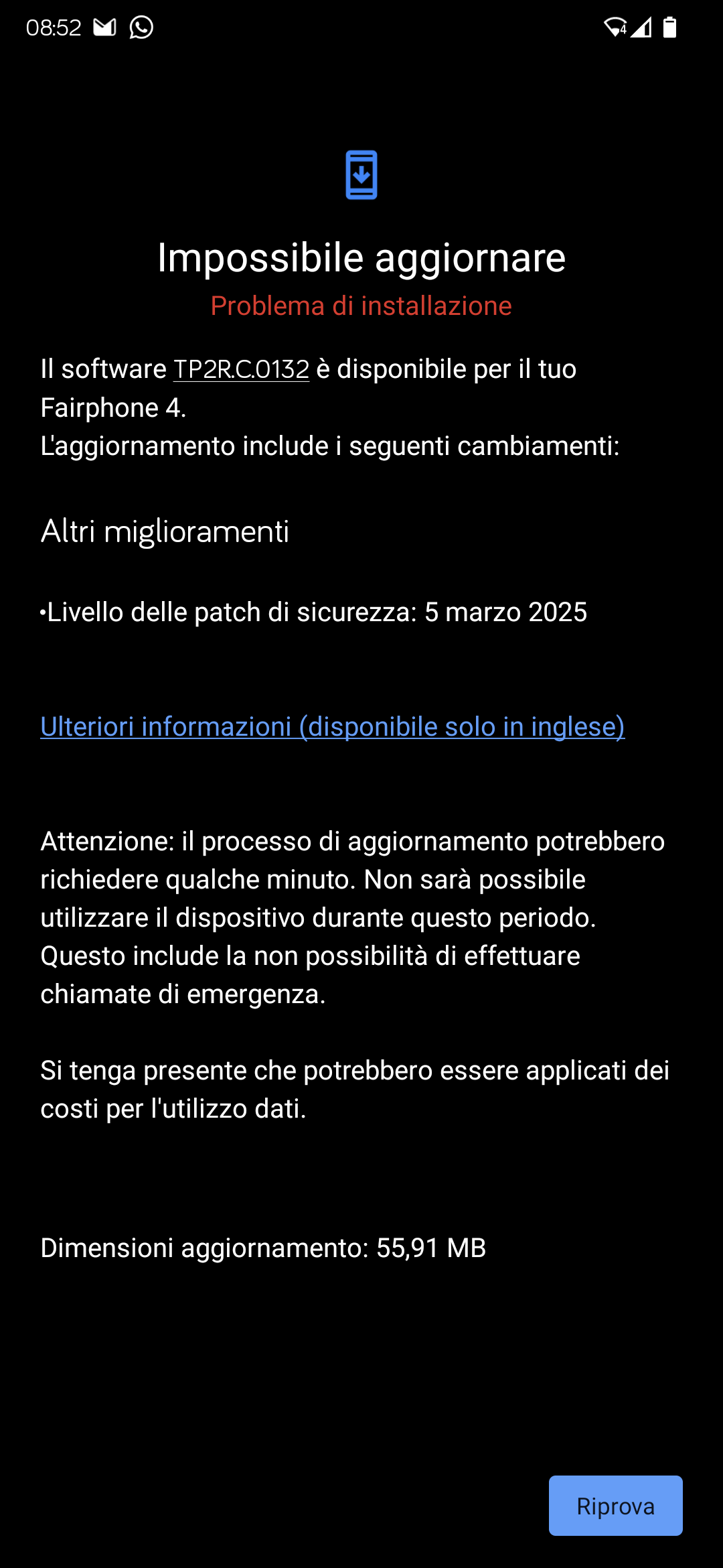

TP2R.C.0132 can't complete
Hi! Reverted to stock OS from /e/ a month or so ago. I see a OS update and trying to get it OTA it can’t complete, no error messages or anything.
Any idea on how to troubleshoot this? Tried both carrier and wifi.
