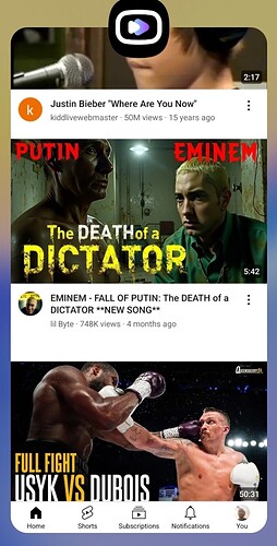

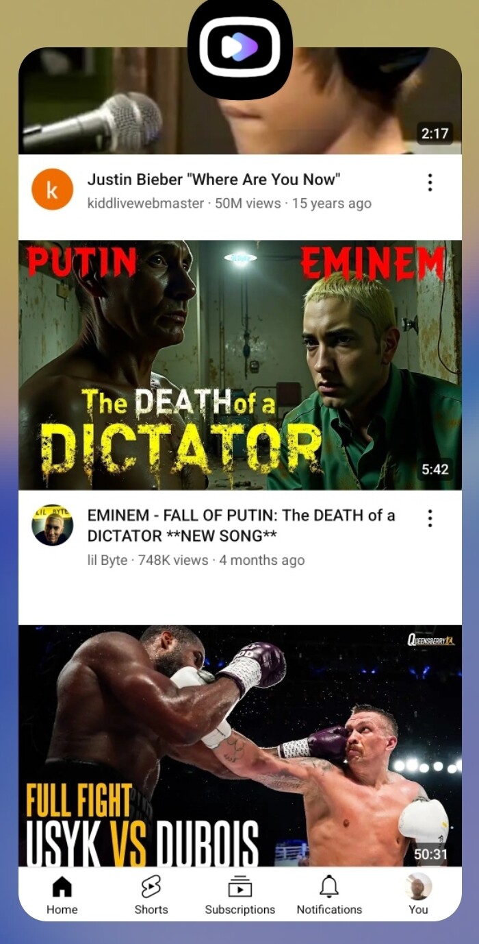

When play a video pause ,buffering etc . Signal isn’t work good in video. Kindly refresh system cleared
@Aleksandr_Avezbakiye, I’d just like to compliment you on your exquisite music taste. You have shown me a new world.
