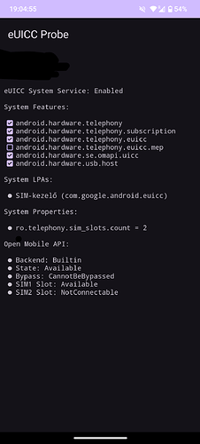

Someone with Fairphone 5 please help me find out Open Mobile API (OMAPI) support
I’m considering buying a Fairphone 5. I’ve got an eUICC SIM card so I want the firmware to support OMAPI so that I can write profiles to the SIM card. Can someone please install the euicc-probe app on their Fairphone 5 and confirm whether or not it supports it? Please send a screenshot of the main page of the app.
Thank you very much! Could you check if the SIM1 slot pertains to the eSIM module or the physical SIM slot? I need it to be available for the physical SIM slot. I think you can find that out by checking the SIM order on the settings app, provided you use both the eSIM module and the physical slot.
SIM 1 is physical SIM
Edit: maybe you find useful info in the schematics
Schematics? Of a smartphone on the market? Disclosed to the public? That’s… wow. That’s amazing! I see on page 68 that the physical slot is wired to the UIM1 pins and the eSIM module is wired to the UIM2 pins. I see on page 58 that UIM1 is grouped with a component that includes SIM1 on its name. It’s very unlikely for the slot order to be swapped on Android so I’m going to take it that OMAPI is available on the physical slot. Thanks a lot!
