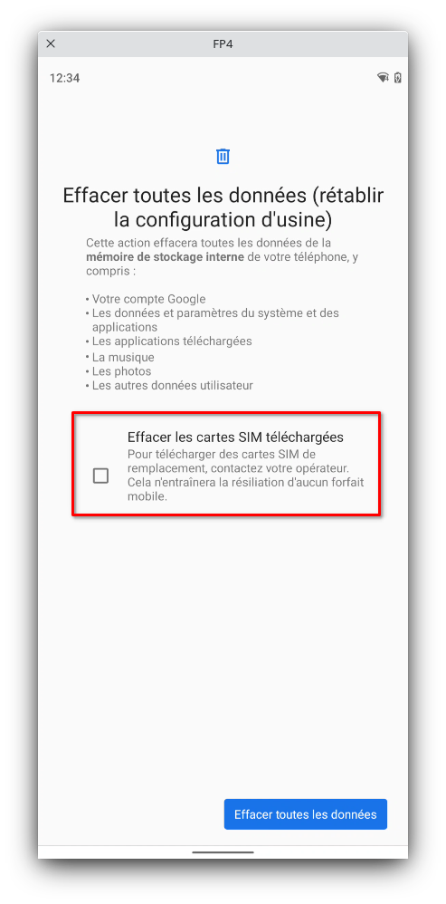

Is that the case indeed? I totally understand your concerns, but I looked around on the internet a bit and found many sources telling (for other phones) that usually the eSIM is not touched unless you explicitely tell the phone to also remove this data. There should be a checkbox or something similar during the reset process.
As someone who has done countless factory resets, I can assure you, the eSIM won’t get deleted if you don’t want it to.
It survives flashing a completely different OS as well :slightly_smiling_face:

Anyway, it is reassuring to know that I can flash the phone without reset the eSIM. Is there a special procedure to do so? Things to avoid?
Just don’t touch that option and you’ll be fine :slightly_smiling_face:
