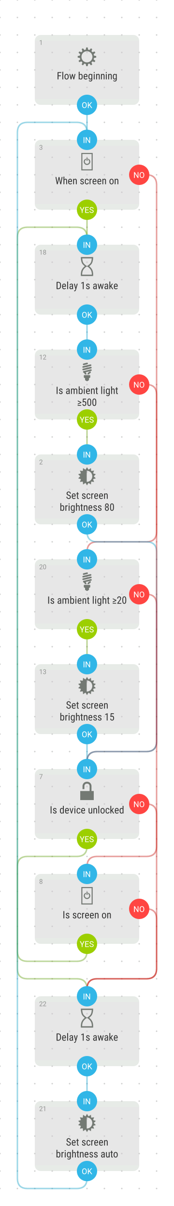

Screen on brightness fix flow for Automate
Here’s another flow for Automate, this one fix the screen on brightness problem that has been reported in another thread. Parameters can be customized if necessary by changing the flow blocks.
Screen on brightness fix, version 1.1.
Make sure to give permissions to all necessary Automate functions.
Download flow here.
Flow diagram:

Updated flow to version 1.1: increased brightness under intense ambient light and increased sensor stabilization delay before triggering auto-brightness mode to avoid occasional fallback into low brightness.
