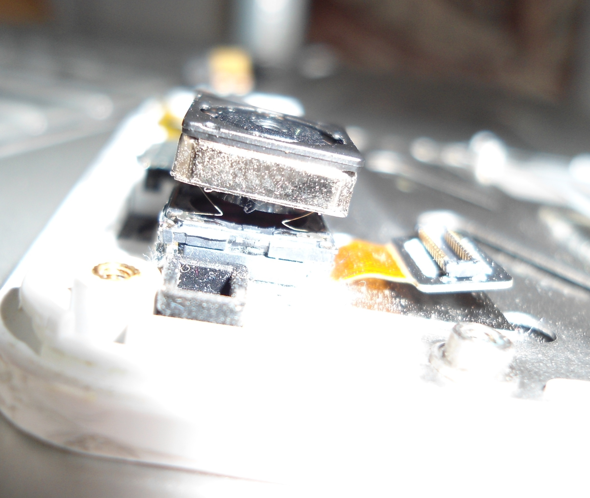

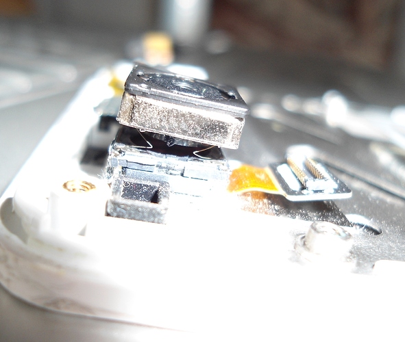

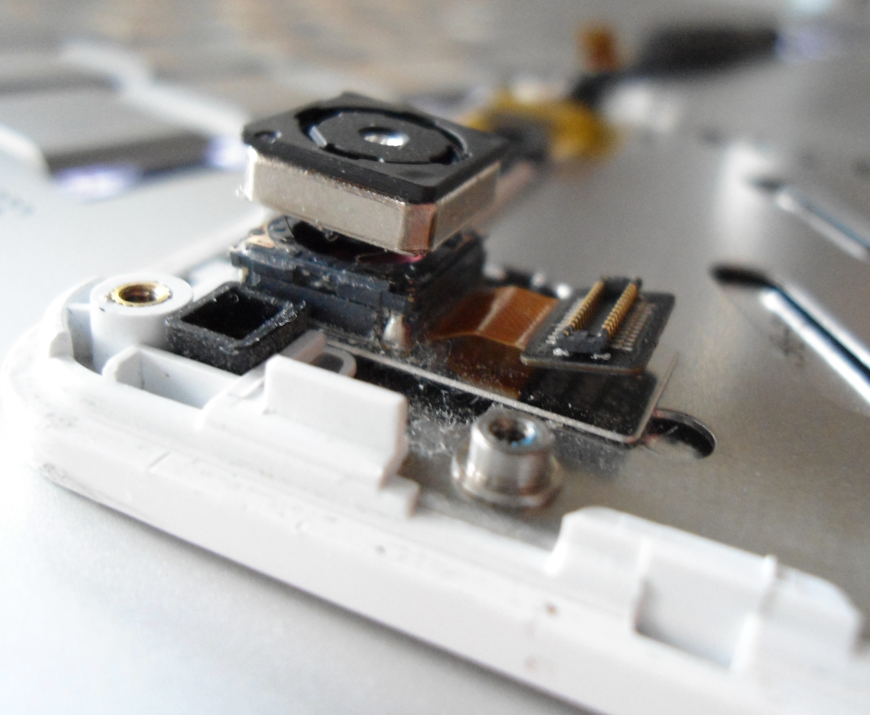

for reference: here’s a picture of a broken FP1 camera (or rather the broken focusing mechanism). The camera stopped focusing (only clear focus at ca. 3-5cm distance). It seems like the glue between the focusing mechanism and the camera housing failed. Maybe this is useful for others…

I had to disassemble the FP1 (for a different repair). When I opened the case, the lens came off the camera, with four tiny wires dangling from it. I think that it was loose already before, because photos became less and less focussed over time.
So I didn’t manage to put the wires back to their correct location on the sensor module, which means that the lens is unable to focus now. What do you recommend to repair the camera module?
Do you think there is a way? I would prefer this to getting a new camera, because I am currently living abroad without access to shipping.
Thanks
