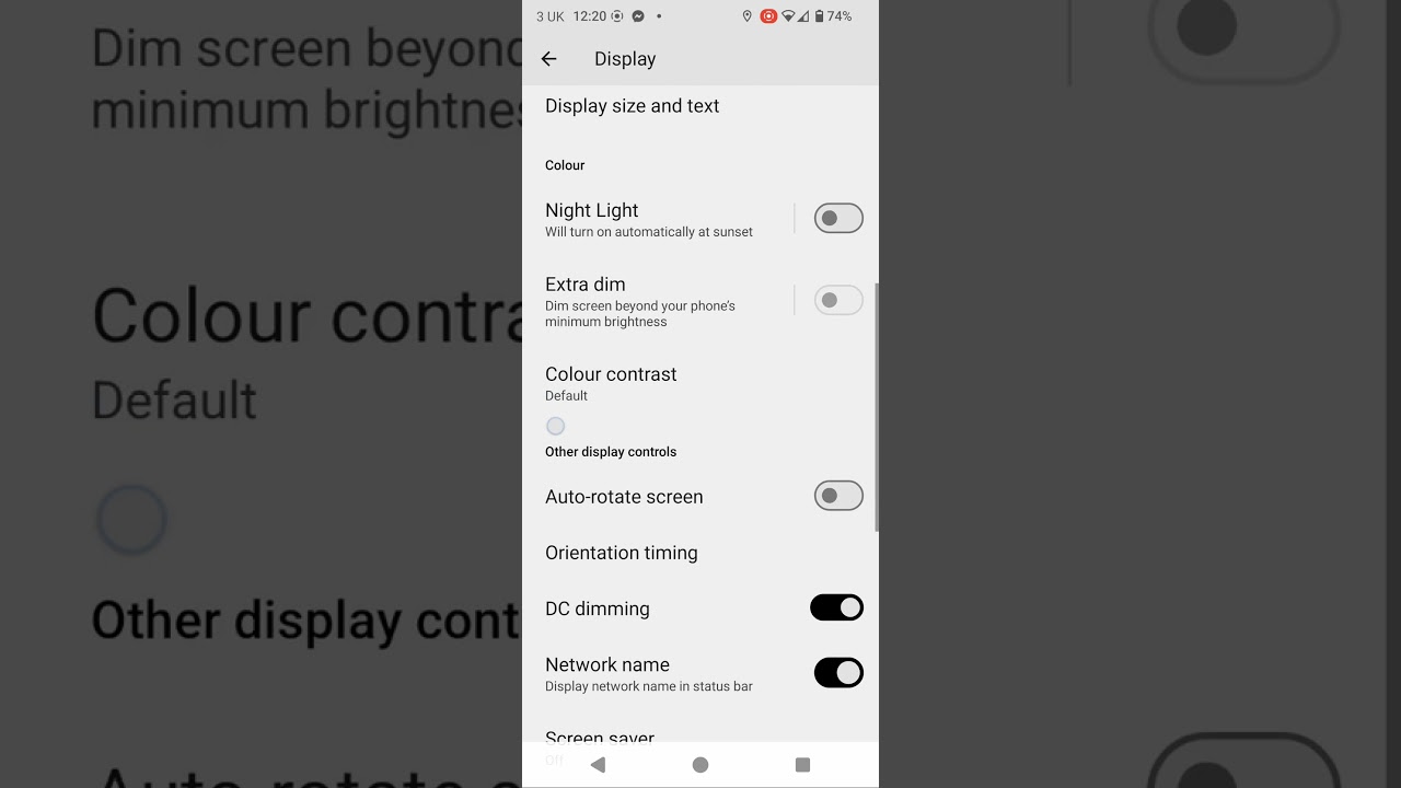

I’ve finally recorded proof (on android-15, too!):
However, the uploaded video’s too choppy to tell. Consequently, I’ve uploaded the original file to mediafire.com/file/h24zyi4w5aiwni9. I wouldn’t need to if I’d remembered to enable the damned indicator.

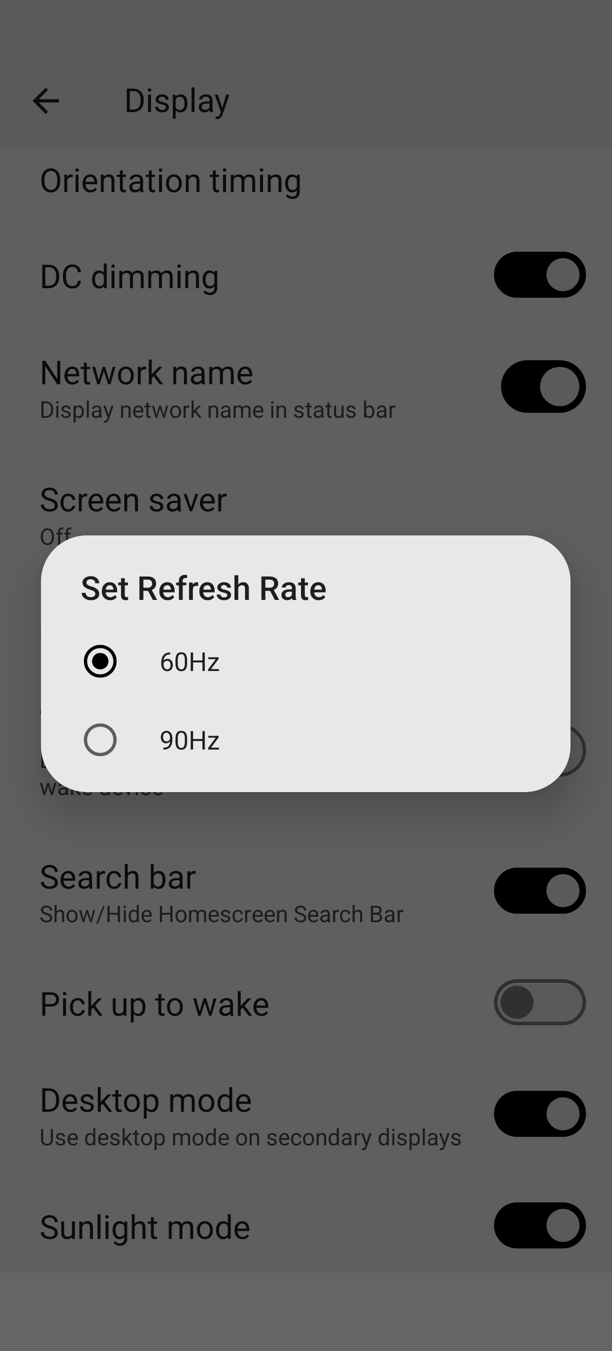

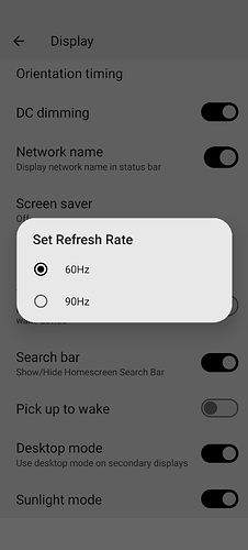

This time, the refresh rate was reduced on boot after a reboot [1] from 90 to 60 Hz, but at least it correctly informed me so:
Perhaps, these are separate problems.
