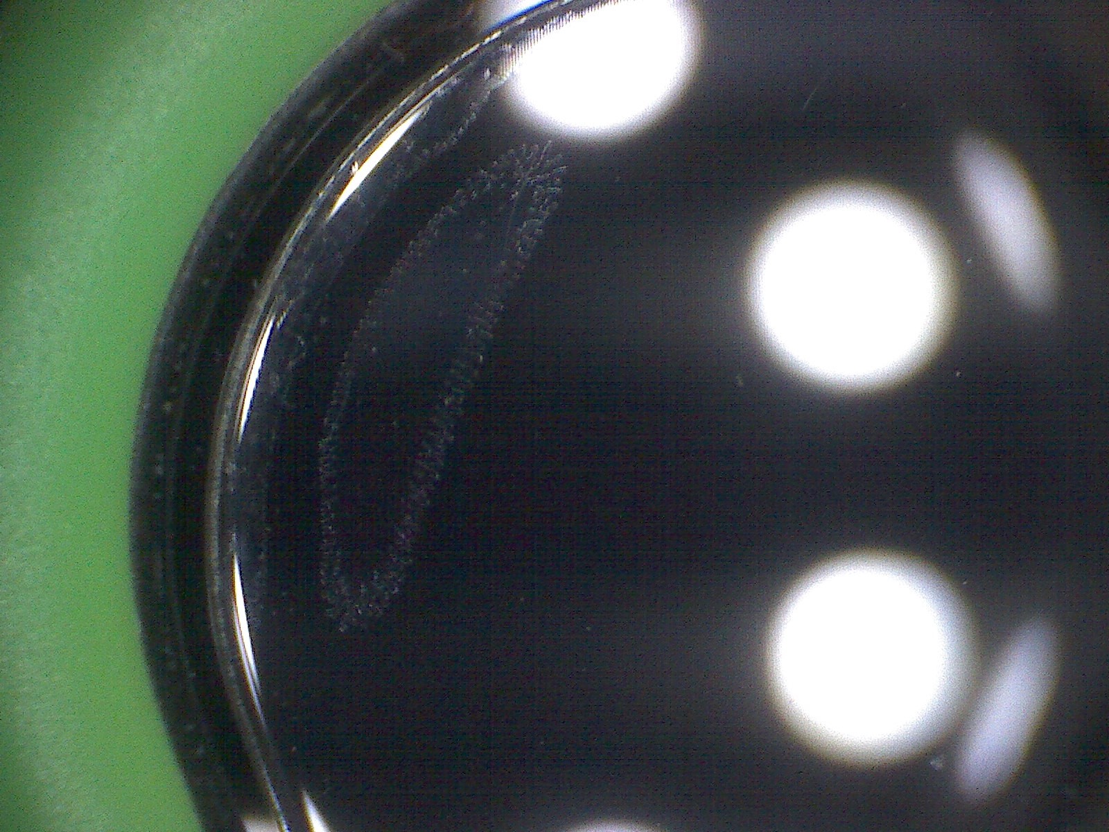

From the looks of it the glue used is not the ‘permanent’ type. No Liquid Optical Clear Adhesive (LORA), since it does not require curing with a UV light and can be removed without issues. Seems to be a Optically Clear Adhesives (OCA) film like 3M 8212, ARcare 92524 or similar is used to adhesive removable base, something in the line of:
Which makes be believe I damaged part of this film in the corner by improper usage of removal tools (read: trying to remove it at all).
I have played around and made a little hack which somehow fixes it. Using a wooden toothpick as tool. Slightly (1mm) lifting the corner in a dust free environment. Next I taken a few pieces of 3M scotch magic tape to transfer some ‘stickiness’ to the screen (repeat the process a few times). After this ‘sticky’ transfers I lowered the screen again. This allowed the corner to ‘almost’ stick again.
I did some further inspection with a microscope camera, after doing the hack, and this seems to support the hypothesis of damage of the adhesive film by using improper tools:
Not sure how long the hack it will last, but it is the best I can make of it. And will learn to live with it :wink:
