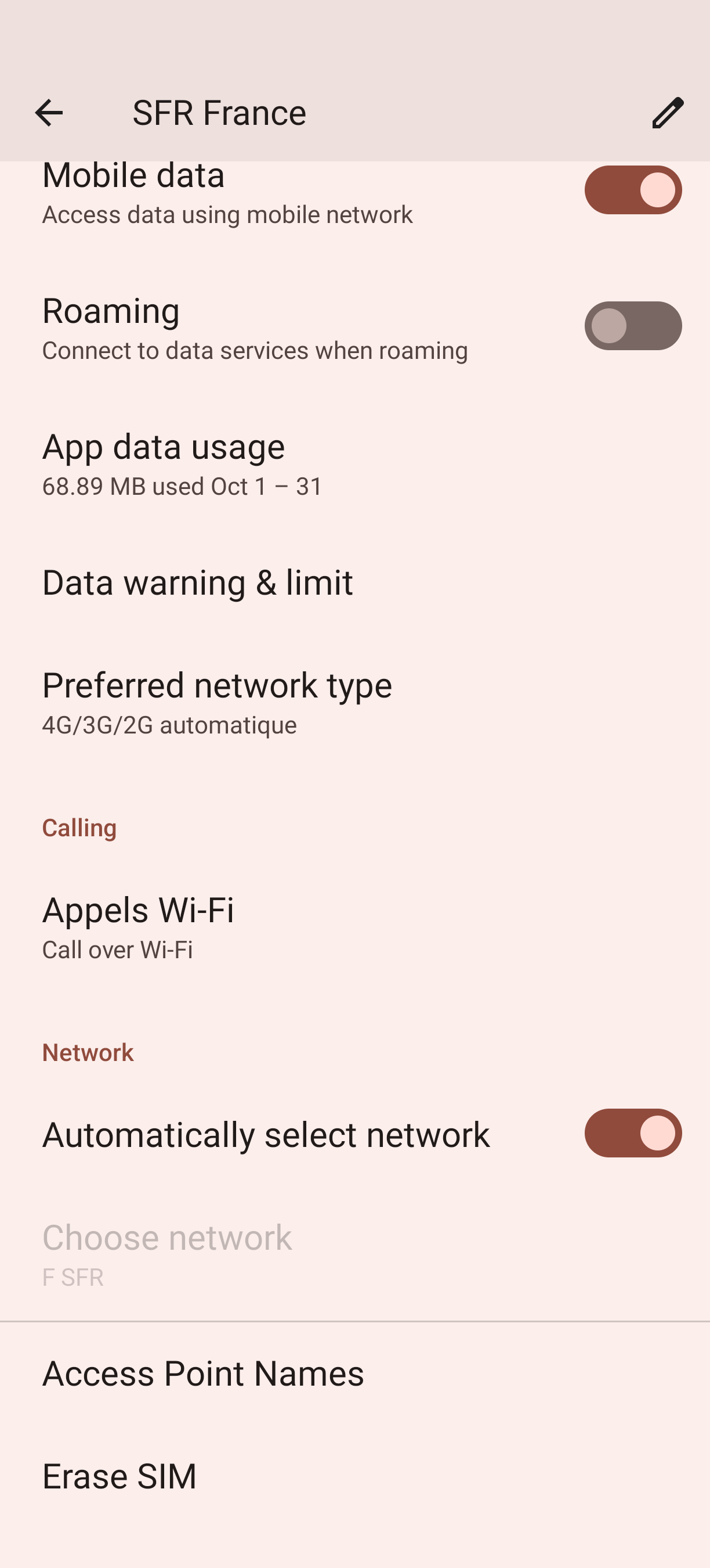

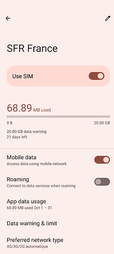

Can you explain where the setting to turn it off is located please ?
i cant seem to find it on my phone.
Maybe this is country/phone plan specific ?
Settings > network and internet > SIMs > 4G calling
Test if it works. Please note I didnt try to check any logs etc
It should be between data warning and limit, and preferred network type. Probably your provider doesn’t support it
That seem to be a provider issue, I have it with a german O2 SIM however not with a german Vodafone SIM. At the moment the provider is trying to find the reason, as it should be there
