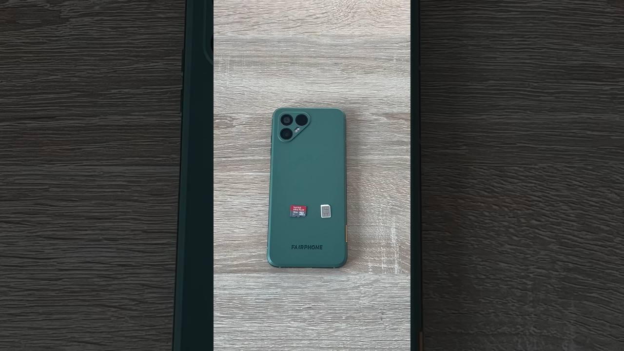

I wanted to insert my micro sim card into my new fairphone 4. But I cannot - the card seems to be slightly too big (or the slot too small). It fits perfectly in my old fairphone 2. And I must say that I am somewhat disappointed that inserting the sim card in fp4 is even harder than in fp2. in other models you just lay it in, in fp you have to push it quite hard. And removing it in a fp4 I guess it is even more complicated than it was in fp2.
The Fairphone 4 has a Nano-SIM slot, not a micro.
So there is a difference in size compaired to the Fairphone 2.
interesting …
in this video
they talk about a micro SD card.
And next to the sim card slot inside fp4 it´s written “micro sim”
but on Fairphone web site I found now the product details - there it says nano-sim
Thanks for info!
From what I understand from the clip they talk about two different slots - one for a simcard, and specifically, a nano-simcard and the second slot for a memory SD card, this one is a micro SD memory card. The slots should not then be confused
