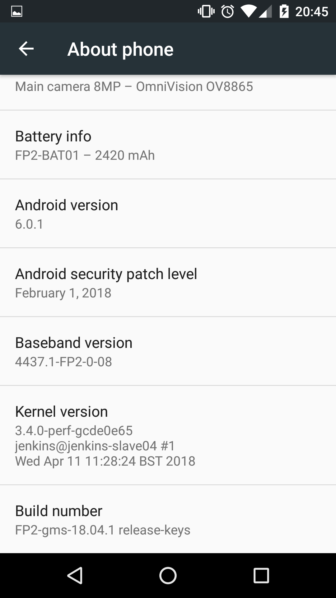

In case it’s relevant, I included some screenshots of the phone info.

Not quite. Fairphone are currently rolling out Android 7, you should be getting it soon. Check the Updater App regularly … and backup or sync your important data, contacts, etc. to somewhere safe beforehand.
