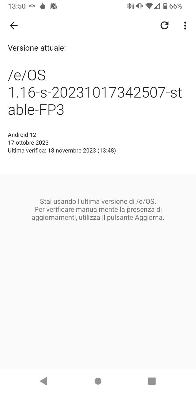

I have an FP3+ with /e/ 1.16.
I received the system message twice, announcing the availability of 1.17 update.
Entering the setting screen confirm this availability.
But when I enter the update screen no update is listed.
Doing a check give no update avalaible.
See attached screenshots.
Anyone had the same problem? Is there any solution?
Many thanks. Marco
Have you tried to tap the “reload” icon (next to the three dots in the top right) 3-4 times?
Super weird! I obviously already done that a lot of times.
But, just in case, I retried.
First 4+ reload make only the message on setting screen disappear.
Second 4+ reload after restarting the phone again make update appear again.
Immediately starting update, just in case … !
Thanks.
While it may look weird, there’s nothing weird or phantom at the core of it.
/e/OS updates tend to be released in a staggered (or staged) rollout in the beginning. This means that a new update will not be available to every device immediately. This has advantages considering server load and detection of issues with the update (in which case not everybody will be affected immediately).
The way /e/OS technically achieves this looks like they randomise availability. At one moment the update server will offer the update to the /e/OS updater when contacted, at another moment it will not.
(This can easily be seen by looking at and refreshing the respective server page in a browser. The page in your case is https://ota.ecloud.global/api/v1/FP3/stable, and we’re looking for 1.17-s in it … sometimes it will be there, sometimes it will not, currently.)
So, what you are seeing would most likely be by design, and @urs_lesse would be correct … just try to refresh the updater. Since it looks random, more tries than 3 - 4 times could be needed as well.
If @urs_lesse suggestion doesn’t help you could try to clear the storage of the updater.
Go to the app “Settings,” and type in the search bar : updater. Open Updater “App info” then open “Storage & Cache”. Clear Storage and Clear Cache. Close settings and then open “Settings”, “Updater” and Updater App worked again.
