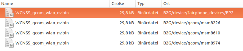

@fp1_wo_sw_updates i don’t find the first file in my FPOSOS build and in the FFOS build. I made a seach and picked a screenshoot:
FFOS:
FPOSOS:
Are you shure you have this file in the persist folder?

It’s not so important where the file is, but that it gets found. The logfile provided showed that there is a problem reading/opening the file, if I understood all that correctly.
More logfiles (logcat, dmesg) are needed. Just look for the filename inside the logs, so you don’t have to publish too much info. I think the software checks in both places.

@fp1_wo_sw_updates As you mentioned the file WCNSS_qcom_wlan_nv.bin should be found on two locations and according to the Makefiles in device-fairphone2 this should be realized by copying it to /persist and linking to that file:
FP2.mk line 76
#wlan driver
PRODUCT_COPY_FILES += \
    device/fairphone_devices/FP2/WCNSS_qcom_cfg.ini:system/etc/wifi/WCNSS_qcom_cfg.ini \
    device/fairphone_devices/FP2/WCNSS_qcom_wlan_nv.bin:persist/WCNSS_qcom_wlan_nv.bin
AndroidBoard.mk line 148
#Create symbolic links
$(shell mkdir -p $(TARGET_OUT_ETC)/firmware/wlan/prima;
ln -sf /persist/WCNSS_qcom_wlan_nv.bin
$(TARGET_OUT_ETC)/firmware/wlan/prima/WCNSS_qcom_wlan_nv.bin;
ln -sf /data/misc/wifi/WCNSS_qcom_cfg.ini
$(TARGET_OUT_ETC)/firmware/wlan/prima/WCNSS_qcom_cfg.ini)
These Makefiles confuse me a lot.
Hi. I only checked where in the the log file the system was searching for the wlan drivers and having issues. If they aren’t there in your build, just copy them there.
The Makefile as shown just creates two symbolic links from the “persist” folder to the newly created (mkdir) target etc folder. For me all this looks good. If you look at the system image, you should be able to find the file under:
etc/firmware/wlan/prima/WCNSS_qcom_wlan_nv.bin
as a symbolic link like this:
./system/etc/firmware/wlan/prima/WCNSS_qcom_wlan_nv.bin -> /persist/WCNSS_qcom_wlan_nv.bin
Maybe you have a broken symbolic link?
If /persist/WCNSS_qcom_wlan_nv.bin is not around or does not get copied to the image, the file will not be around. So you need the file that provides the persist “folder” as well.
Normally there should be a “persist.img” as well that supplies this folder.
Note: I hope this will not kill your system, but maybe you need to do something like fastboot flash persist persist.img. Have you found something like this for Firefox OS? Please check if something similar is done during the flash process.
