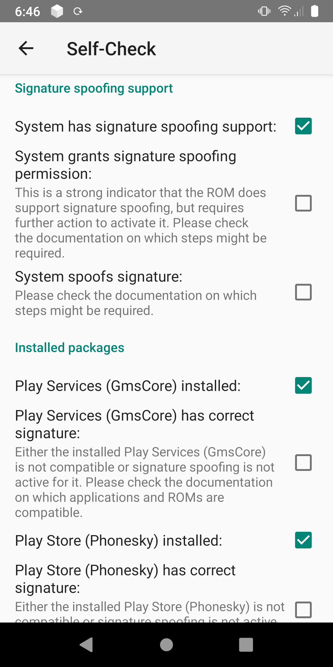

Yep, I did. Selfcheck does not check all boxes, especially the top section. Still try to figure out whether I can get it up and running. Besides that everything seems fine!

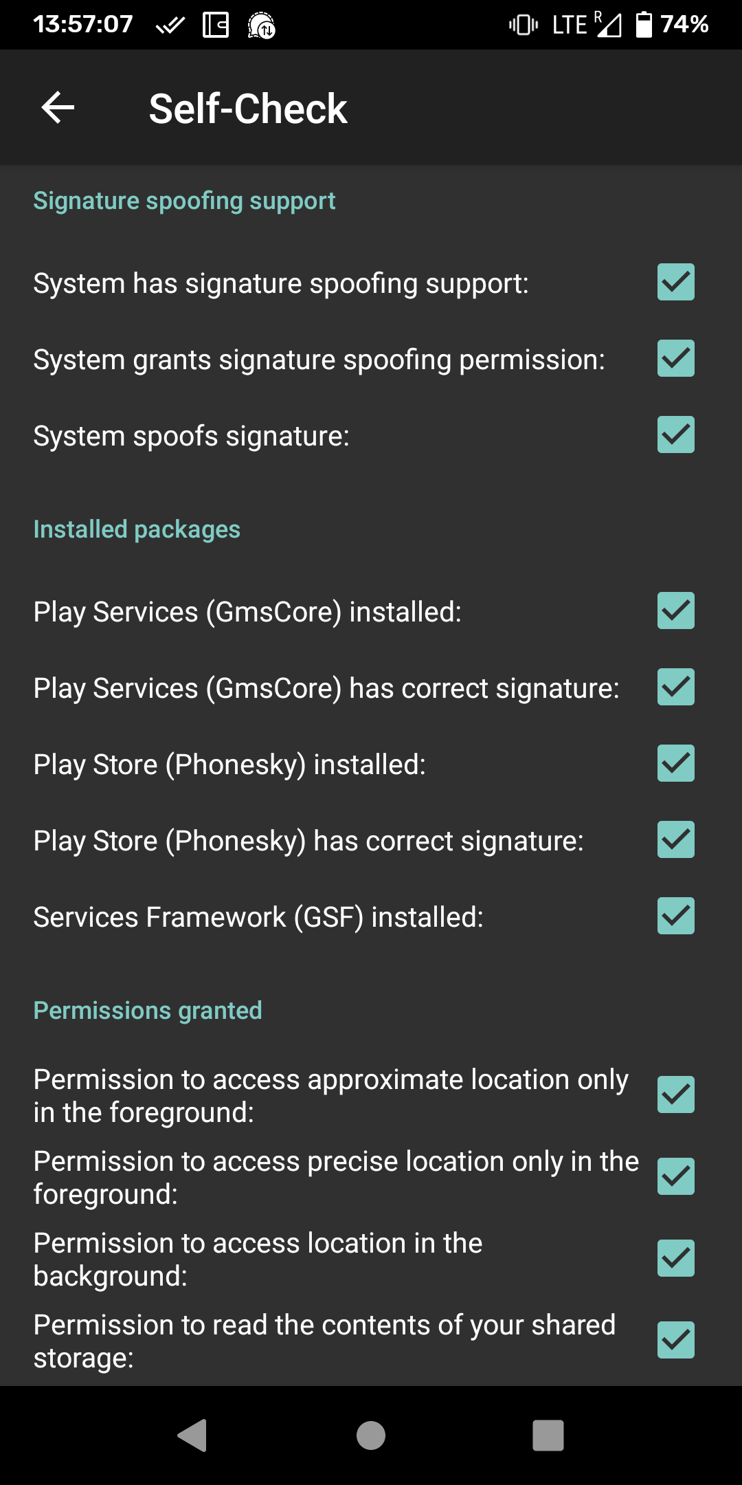

I made a full wipe (but this might not be necessary), flashed LOS-MicroG 18.1 and the respective recovery, reboot, installed Magisk.apk, reboot in bootloader and via bootloader in TWRP, flashed Magisk.zip, reboot, Busybox via Magisk, reboot and than I used as MicroG installer the MicroG of FriendlyNeighbourhood Installer: GitHub - FriendlyNeighborhoodShane/MinMicroG: Sources and scripts for MinMicroG installers. You shall find. Flashed it via Magisk - this worked I have now all boxes checked, spoofing works, the patched Playstore works as well

For me, all the microG selfcheck checkboxes are marked as working…

For me, LOS4microG works without any issues. All self-checks seem to pass without a hitch:
